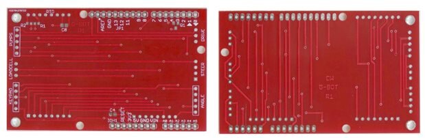

Here is what the bare card looks like:
It is red because that was the lowest cost color at the time of ordering.

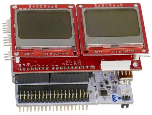

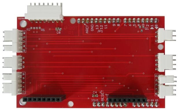

Here is what it looks like assembled with connectors for 2 LCDs, 3 sensors, 10 motors, a keypad and the MCU:
Here is what it looks like stacked on the MCU with sensor tile and LCDs:
Here is a quick video showing my first program that ensures I have the connections right for the LCDs:
It is always a great day when a PCB fires up without problems.
