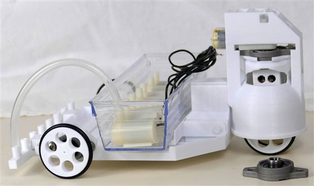

Another eventful week - most of it spent in Washington, has made the rest of the week ultra busy. The challenge deadline is looming and the mechanical design really needs to get done so I can start wiring everything up. The design of the front end and the chassis turned out to be quite complex, partly because there are limits to what a 3D printer can do and I always try to print without any support structure.

Fortunately all the parts printed well and I didn't have to re-do any time-consuming printing tasks.
It remains to be seen how well the printed bearing (bushing) in the steering mechanism will perform under load. I had to leave enough play for it to rotate freely, which makes it quite a bit sloppier than a proper pillow block bearing. The rest of the parts are all nice and tight.
I was looking around for an alternate (local) supplier for the pillow block bearing and discovered to my surprise - Walmart has it in their on-line catalog, however it would still entail shipping from China.

The steering pillow block bearing finally came in - of course it had to happen after I had designed a substitute 3D printed part and videoed the assembly, but it fits snugly and I am happy it arrived. This image shows it installed as well as a second bearing (upside down) beside the front wheels. I also connected one of the tubes to show how they will look.
I couldn't resist hooking the main drive motor up to a power supply just to make sure it could handle the load (I added weights to the reservoir to make it realistic). This is actually a nice milestone - the robot platform moved well under its own steam.

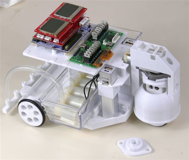

In this update I designed and printed the mezzanine structure to hold the electronics. There are now about 28 printed plastic parts in the assembly.
I don't have enough time to enclose the electronics in a GT fairing, but at least they are mostly above the water  level.
There is more that could be done to cover the reservoir and the electronics and improve the aesthetics, but the mechanics are complete enough to be fully operational.
The assembled platform is shown below:
Note the two batteries - one for the electronics and one for the motors.
I have also been dabbling a bit with the software but tomorrow I need to wire everything up so I can test software as it gets written.
It could be another late night as I have to play hockey as well.
I probably won't have enough time to dress the wiring neatly, so it could end up looking a bit like the proverbial spaghetti factory.
