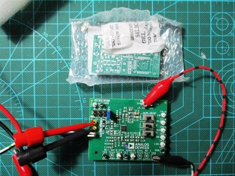

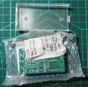

Yesterday, I have received my PCB and components for the ECG and EMG modules those I have ordered separately. KHIKZZZZ
So, when I am preparing to pack up everything regarding Sudden Impact for a while, it gave me a new KICK and I have started working again image.
Right now I am assembling the boards - hopefully I'll post the outcomes later on [blog - "Total Player Monitor" in my profile].
Best of luck to everyone image
  ECG / EMG full module bare PCB beside AD8232 Evaluation board                      assembled PCB will be coated by resin and placed inside the transparent enclosure

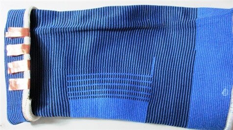

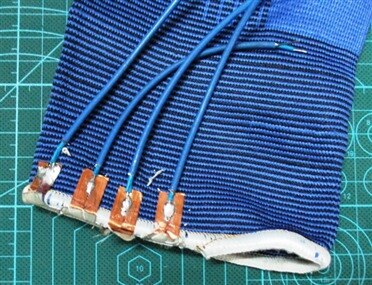

some images on preparing the knee pad to place the EMG electrodes and module ->
Foam pad is placed to maintain an even pressure distribution on the electrodes         Copper tape is used to connect the cable with conductive fabric electrodes
Conductive fabric is stitched to use as EMG electrodes                                             Wires are soldered out from the outer side. Joints will be covered by resin and soft piece of cloth
