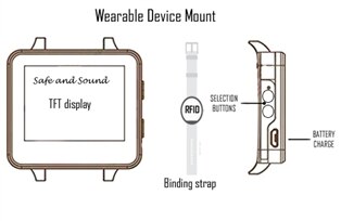

This blog is about the Hardware design of the wearable device that will be mounted on the wrist of the Miners.
Objective:image
The first part of my Project Proposal is to design a wearable device that contains the sensors for collecting the environmental information.
The Launchpad, sensor boosterpack and other necessary components in-together will be quite big and bulky to fit on the wrist. So, my objective is to design a customized board to make it wearable.

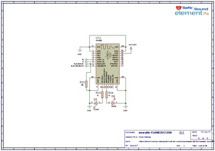

Board Design:

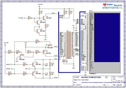

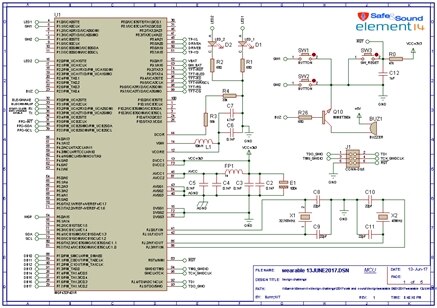

MSP432P401r [MCU and other supportive circuitry] -                                           TFT display -

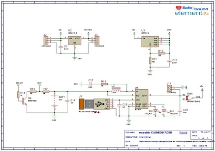

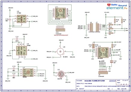

Sensors -                                                                                                    Power supply -
Bluetooth Low Energy -

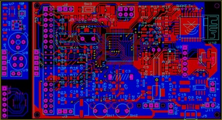

PCB:

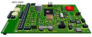

3D Layout:
** that's basically the end of the designing the first part [wearable device] of my proposal. As the time is short, I'll try to develop the board later on, if I can manage some time.
Meanwhile,
I placed the order for PCB fab on 20th June.
Unfortunately, the delivery got stuck into EID vacation [it's a big one in my countryimage]  and customs clearanceimage
However, I have received it yesterday. I don't have much time left for the Project Submission.

    about MAX30100, I would like to suggest to go for MAX30101 or MAX30102. As far as I know MAX30100 is no more in active production.
    This sensor provides control over I2C communication. However, you need a separate 1.8v supply for it.
    you can follow the application notes from MAXIM for guideline on how to use this chip.
    this link also provides some valuable info ..... https://morf.lv/implementing-pulse-oximeter-using-max30100
