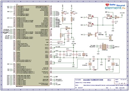

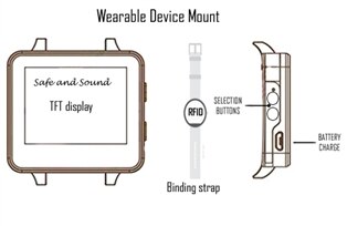

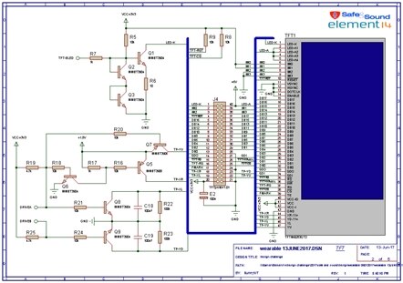

This blog is about the Hardware design of the wearable device that will be mounted on the wrist of the Miners.
Objective:image
The first part of my Project Proposal is to design a wearable device that contains the sensors for collecting the environmental information.
The Launchpad, sensor boosterpack and other necessary components in-together will be quite big and bulky to fit on the wrist. So, my objective is to design a customized board to make it wearable.
Components of the Wearable Device -
  • MSP432P401r

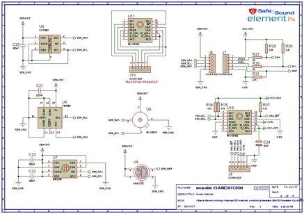

  • Sensors -
    • OPT3001
    • BME280
    • TMP007
  • TFT displayimage

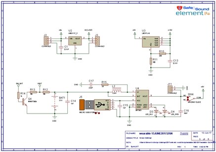

  • Power supply
  • Battery charger

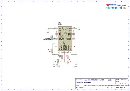

  • BLE [RN4020] to send/receive beacons in between miners, in case of emergency
Board Design:
MSP432P401r [MCU and other supportive circuitry] -                                           TFT display -
Sensors -                                                                                                    Power supply -
Bluetooth Low Energy -

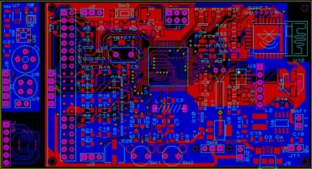

PCB:

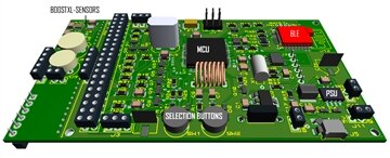

3D Layout:
** that's basically the end of the designing the first part [wearable device] of my proposal. As the time is short, I'll try to develop the board later on, if I can manage some time.
