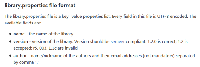

In the end I tripped over this document that helped explain some .... BUT not all the messages.
https://github.com/arduino/Arduino/wiki/Arduino-IDE-1.5:-Library-specification
Some time ago the Arduino IDE matured, and they changed a few files that the IDE uses.
You often had a library that didn't work on one version (023 or 1.xx) or the other and it needed some cleaning up.
You now see a line that checks which IDE version and will change the file used, so one library can handle old and new IDE's  ...
In order to benefit the open source community a guideline has been produced, and how to get your library into the IDE builds.
I suspect there was nothing wrong with any of the libraries I was trying to add, it's simply the IDE that was at fault.
In one attempt I had it complain about the lack of email, yet this is an option according to the spec.
I cured it by adding email =  on a new line, and that error went away.

    Hey Mark, Many of the library issues I've been finding have to do with how the #include statements are written: (from https://gcc.gnu.org/onlinedocs/cpp/Include-Syntax.html ) 2.1 Include Syntax Both user…
  • rsc
    rsc over 9 years ago
    Hey Mark,
    2.1 Include Syntax
    Both user and system header files are included using the preprocessing directive ‘#include’. It has two variants:
    #include <file>
    This variant is used for system header files. It searches for a file named file in a standard list of system directories. You can prepend directories to this list with the -I option (see Invocation).
    #include "file"
    This variant is used for header files of your own program. It searches for a file named file first in the directory containing the current file, then in the quote directories and then the same directories used for <file>. You can prepend directories to the list of quote directories with the -iquote option.
    When you got the error:
    Intel_Edison_I2C_LCD.ino:66:37: fatal error: Adafruit_RGBLCDShield.h: No such file or directory
    If you copied the file Adafruit_RGBLCDShield.h into the same directory of your sketch, it would probably compile with the include being:
    #include "Adafruit_RGBLCDShield.h" and not:
    #include <Adafruit_RGBLCDShield.h>
    Hope this helps
