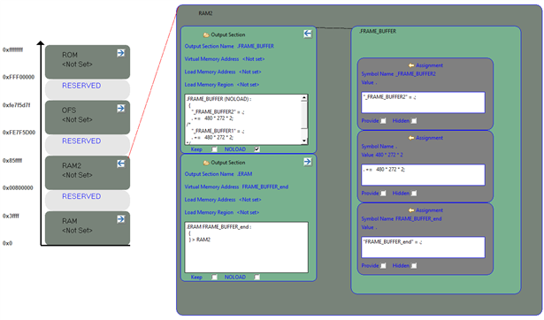

See the header image of this post for the graphical representation that's available.

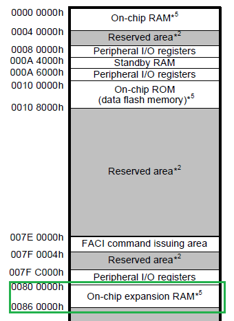

For this exercise, let's use the 2nd block of RAM available in this controller, called On-chip expansion RAM in the datasheet extract below:
image source: annotated from Renesas RX65N data sheet
In the linker file, this memory area is named RAM2, and not used to place any objects by default. It's an unmanaged area out-of-box.
I'll be using it to fix an area for the frame buffer. Anything else placed in that memory part in later developments (E.g.: an additional frame buffer, a chunk of code, data, freely allocatable memory) will be placed after that chunk.
SECTIONS
  .FRAME_BUFFER (NOLOAD) :
    "_FRAME_BUFFER2" = .;
    . +=   480 * 272 * 2;
    "_FRAME_BUFFER1" = .;
    . +=   480 * 272 * 2;
    "FRAME_BUFFER_end" = .;
  } > RAM2
  .ERAM FRAME_BUFFER_end :
  } > RAM2
The .FRAME_BUFFER section will take the first chunk of the expansion RAM. It's the first section that's told to place itself in RAM2 (> RAM2).
So it's guaranteed to be at the memory address 0x008000000.
I declared a label called _FRAME_BUFFER_2, with address . (current).
That can later be used (it becomes a variable name with known address) in our C firmware to tell the LCD library where the buffer is allocated, without hard-coding the address in the C code. I'll come back on that in the Firmware description.
Then I tell the linker to skip (fill) 480 * 272 * 2 bytes. This represents a LCD size of 480 * 272, and 2 bytes per pixel for the colour value.
It doesn't actually physically do anything with that area, not at loading and not during runtime. The area is not loaded nor initialised. But it's occupied and won't be taken by something else.
I've placed a commented out placeholder for the other buffer. My program does not use tha buffer so I didn't reserve it.
Note that there is actually not enough expansion RAM to store a second buffer with that size. Just comment out the declaration and try to build the program.
The linker will fail with a message that you are overrunning the RAM2 area. That was one of the purposes of this blog - having the linker support and guard memory management.
If you'd just hardcode the start addresses for the 2 buffers in your C program, nothing would warn you that te second chunk overruns into the reserved memory area at 0x00108000. correction - thank you Andrew J  : 0x00860000.
The datasheet says "Note 2. Reserved areas should not be accessed" but you'd find that out by the program crashing during paint commands instead of the build process flagging it.
Then I've created a label .FRAME_BUFFER_end, that's representing the first address after the memory space taken by the buffer(s).
That's used as a start point for the next section, named .ERAM by me. This section is the remainder of the expansion RAM, free to use for other purposes.
