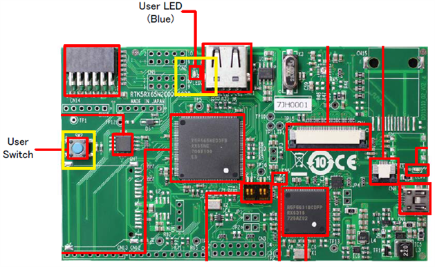

It's not a real blinky - it's a switchy. The User LED is on when the User Button is pressed.

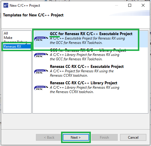

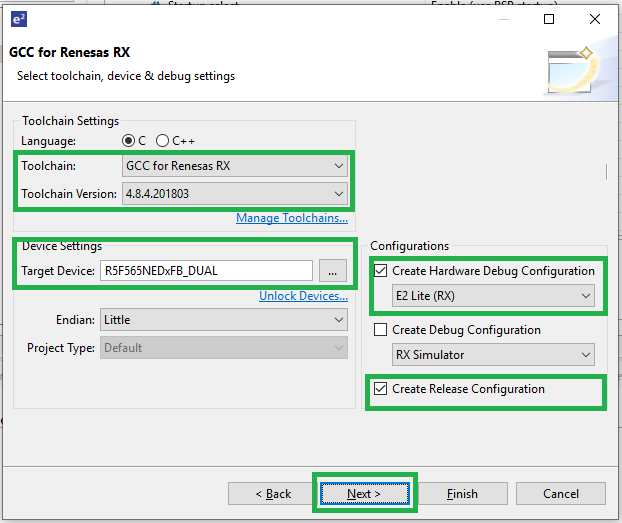

File -> New C/C++ Project -> Renesas RX -> GCC for Renesas RC C/C++ Executable Project -> Next
Name your project -> Next.
Toolchain: GCC for Renesas RX, latest installed version
Select the correct tatget for this board (for navigation, see the previous post).
Set the E2 Lite (RX) debugger and create a release configuration too. -> Next
Enable Use Smart Configurator -> Finish.

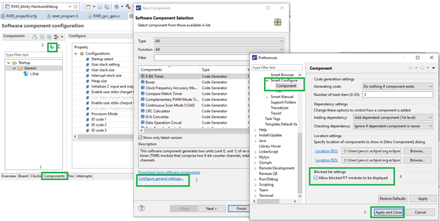

On the Components tab, press the + button.
This brings up a list of available components.

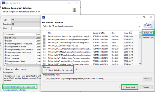

The first time, we have to do two steps (Renesas gurus may chime in here to refine what needs to be selected/configured).
Change the IDE configuration to allow that blocked modules are shown.
Configure General Settings -> Enable Allow blocked FIT modules to be displayed -> Apply and Close
Then add all components . This takes a long time.
Download more software components -> Disable Show RX Driver Package only -> Select All -> Download.
Go for a coffee.

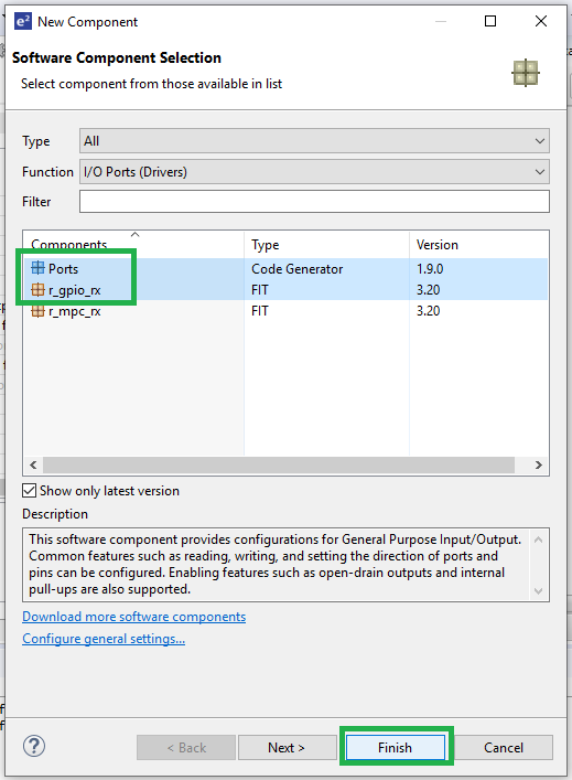

Once they are added, select these two:
  • Ports: to enable the ports and pins, and set the direction
  • r_gpio_rx: to add the pin header file and gpio APIs.
Cick Finish.

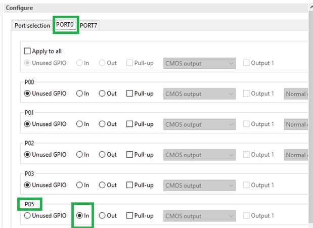

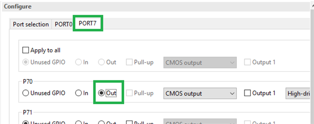

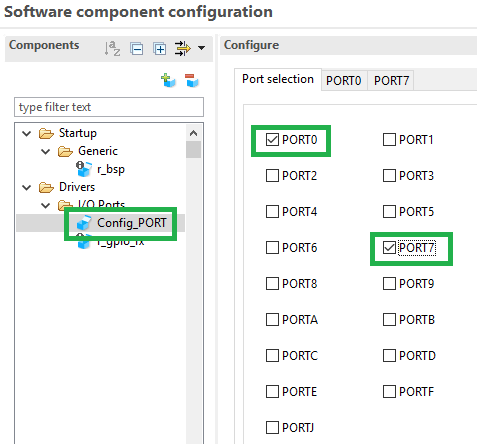

The user switch SW2 on the evaluation board is assigned to Port 0 bit 5, the LED2 blue led to Port 7 bit 0.
We'll set these pins as I/O functional inputs and outputs.
Select the Config_PORT module and enable PORT0 and PORT7. 2 new tabs appear.
Select tab PORT0 and set P05 to In.
Select PORT7 and set P00 to Out.

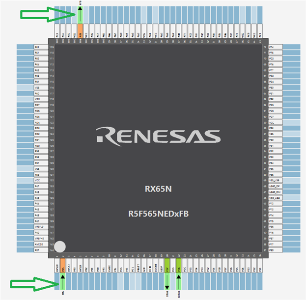

In the MCU package view, these pins have changed colour and definition:
In the Pin tab, they have also changed (here P70 (port 7 pin 0) as example):

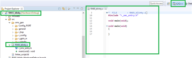

Activate the IDE's C/C++ perspective.
The configurator has created a project structure. Take some time to familiarise.
Then open the main file, RX65_blinky.c.
Let's add the header file for the driver code, and the pin definitions:

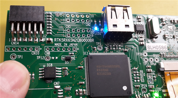

Once the code is running, the blue led next to the USB connector will be on when you push the
