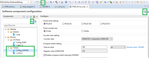

Modify the Project
In the configurator, navigate to the Components tab, select the Config_PORT module and uncheck PORT0.
We don't use the switch anymore. That's why we can remove our claim to that port and pin.

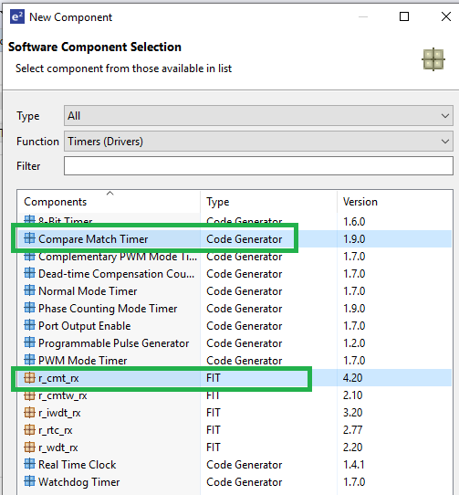

Then add the following Timer blocks:
  • Compare Match timer: this is a compare type timer that can throw an interrupt at expiration.
  • r_cmt_rc for the API functions
Click Finish.
Save the configurator and Generate code.
