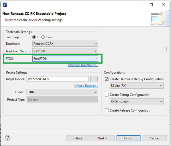

Create the Project
As usual, use Blog #1 to create the project.
The only extra action is to select FreeRTOS while going through the project creation steps:

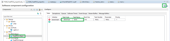

First, let's add an RTOS task that will blink the LED.
In the Smart Configurator, select the correct board, then go to Components.
Select FreeRTOS_Object, and in the Task tab, push the image  button.
Enter
In a few steps, when we generate the code from the configurator, this will create a file /src/frtos_skeleton/vBlinkTask.c, where we'll write the blink code.
Because we need the RX65 GPIO registers, we need to add the r_gpio_rx block in the configurator. Use the dd Component button to add this (see also blog post 2a for a step-by-step guide for this).
When using FreeRTOS projects, it seems that the "Ports" SmartConfig module can't be used.
That's the one that sets in- and outputs. No worries. We'll set the LED2 pin on our board to output mode in our RTOS task.
