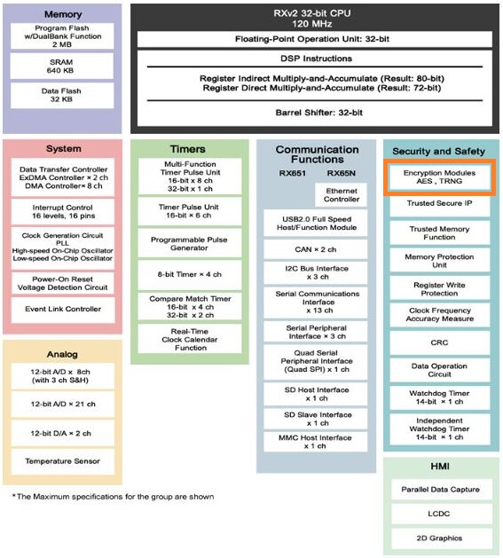

The RX family has models that come with a hardware accelerator for encryption. These devices will offload many of the manipulations of the data encryption and decryption
source: e14 road test home page
In particular when you're using the device in secure communication (e.g. with AWS) this module is one you should consider.

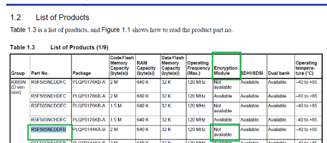

The Envision board has R5F565NEDDFB model. That one does not have the silicon accelerator.
.image
source: Renesas datasheet, annotated
Oddly, the dedicated evaluation kit for secure communication with AWS uses the R5F565NEDDFP that also doesn't sport the encryption blocks..

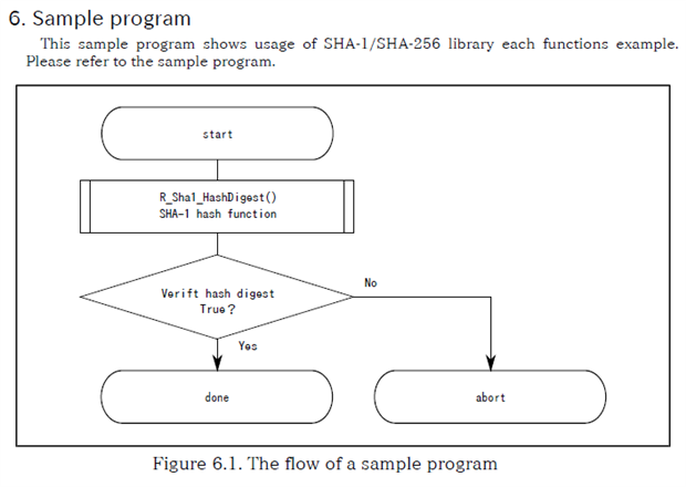

The example is straightforward: It has the known SHA1 and SHA256 digest values for a string of 20 zeros.
It will create a digest for such an array in code too, then verfy that the value is as exepted by comparing it with the known good outcome.
Several mechanisms are used. Single data buffer calculation  and incremental calculation for segmented buffers.
Check the example for all details. I'm showing a simple buffer SHA1 and a multi-buffer SHA256 below:

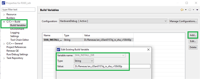

Creating the Example Project in e2 studio
The example in the SHA packet is for a different IDE. Let's create a e2 studio one for it.
To create the project, se the exact same steps as in blog #1. You have to choose the CC-RX toolchain. The Renesas SHA lib is not compatible with GCC's linker.
Once it's created, do these modifications in the Properties:

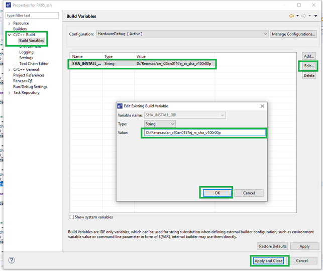

Add an environment variable that points to the place where you installed Renesas' SHA lib:

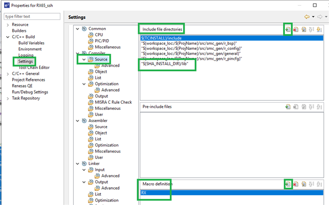

Then, add the SHA include files and set RX definition (not critical, but the build will use the RX own includes where appliccable instead of pulling in the dedicated ones for this lib).
Include dir: "${SHA_INSTALL_DIR}/lib"
Macro definition: RX

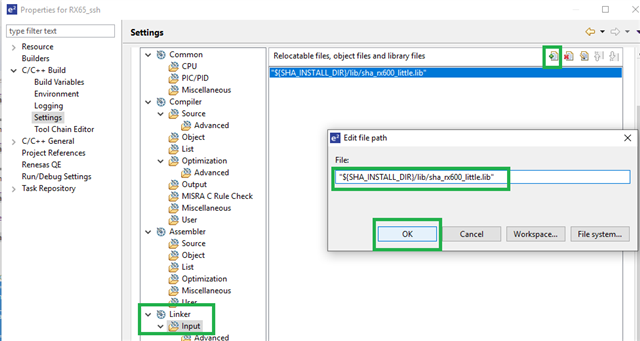

Include the precompiled lib in the linker settings:
library files: "${SHA_INSTALL_DIR}/lib/sha_rx600_little.lib"
Then, copy/paste the example source into the project.
You can do that via the File -> Import menu, or just copy/pasting the file ${SHA_INSTALL_DIR}/sample/src/sha_sample.c. with your OS's file explorer.
Take care that you copy the file, when asked by Eclipse. Don't use the advanced link functionality if you plan to play with it and change it for experiments.

Debug and enjoy. You'll see the library creates the digests, then compares them with the expected value.
If your code ever falls into a fatal_errorxxxx() section, you know something is wrong. This should not happen.
For your convenience, I've attached a e2 studio project.
Before you build it, navigate to the project properties, then change the SHA_INSTALL_DIR build variable to point to the location where you installed Renesas' SHA package on your computer.
