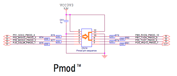

On the Envision board, SCI channel 5 is connected to the debug USB port.
Channel 9 is broken out to the PMOD connector. Other ones are availabe from different locations on the board too.
In this example I'm using SCI channel 9. That allows me to keep using the debug USB for debugging.

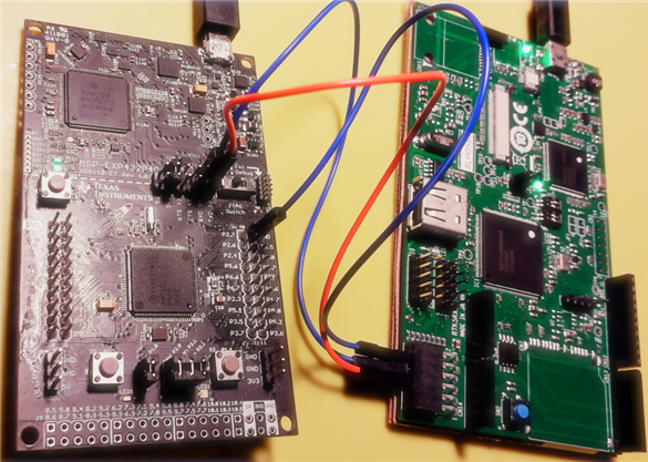

A logic level to USB converter is required. There are (FTDI) cables that can do that (or a Bus Pirate). I'm using the debug section of a TI LaunchPad.
PMOD pin 10 is RX, pin 9 TX and pin 11 GND. With these 3 pins you can make a connection to your logic -> USB converter.

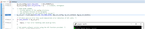

In the main() function, adapt the init code to use channel 9:
    my_sci_err = R_SCI_Open(SCI_CH9, SCI_MODE_ASYNC, &my_sci_config, my_sci_callback, &g_my_sci_handle);

To test the example, you have to connect your USB -> logic level translator to the PMOD connector.
Use the below table as guideline.
PMOD pinRX65N Function
PMOD 9SCI 9 TX
PMOD10SCI 9 RX
PMOD 11GND

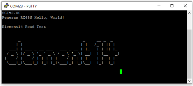

Then use a serial terminal program to connect to that translator, speed 115200, no parity, 1 stop:
Set the traffic for no cho. The firmware will echo when needed:
Connect, Then start the program.
You need to type "any key" (use enter) to start the communication.
First, the terminal will show the SCI FIT module version:
After that, each character you type in the terminal will be echo'd by the device.
If the LED2 does not flash when you type a character in your terminal, swap the RX and TX connections and try again.
