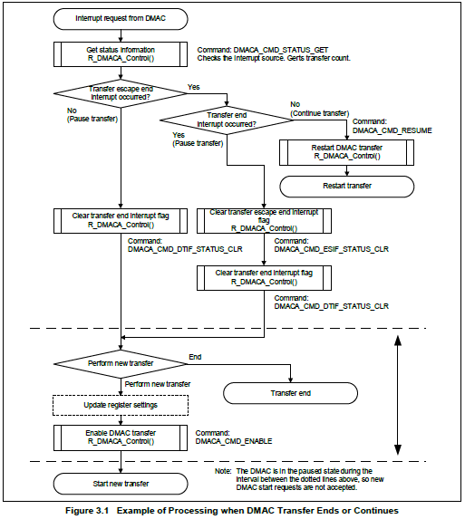

source: application  note R01AN2063EJ0220 DMAC Module Using Firmware Integration Technology
The Example - DMA and ADC
The Renesas DMA example is something you can use in the real world:
One of the ADC pins is sampled 32 times and the data is put into RAM by the DMA controller, without loading the microcontroller.
When all data is available and transferred, the firmware logs it to the debug console.

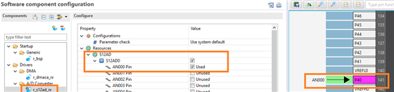

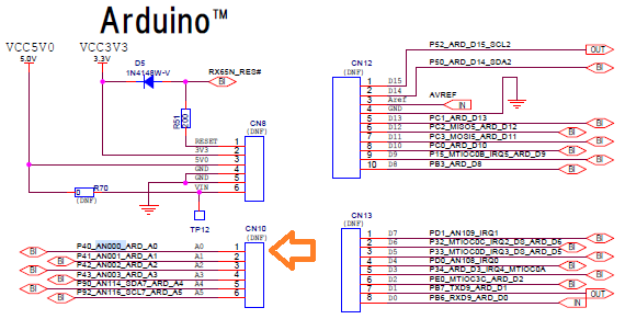

Pin Assignment
The analog input A000 is used. It's broken out on the Envision board to the Arduino connector CN10, pin 1.

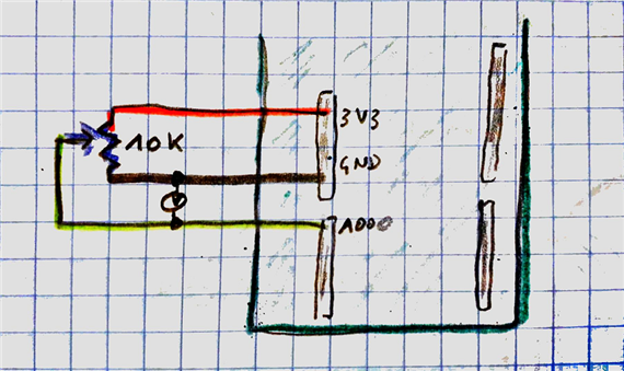

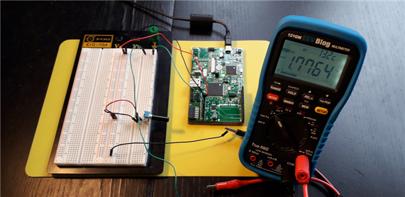

The voltage at this pin will be sampled by the application. That voltage is made tapping off the wiper of  a 10K potentiometer.

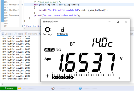

For reference, I've connected a voltmeter to the wiper.
The result is that the log shows a number between 0 and 4095, where 0 is 0V and 4095 represents 3.3V.
The potentiometer can be used to swipe between the two values.

        /* Print out result */
        for (cnt = 0; cnt < BUF_SIZE; cnt++)
            printf("\n DMA buffer no.%d: %d", cnt, g_dma_buf[cnt]);
        printf("\n DMA transmission end \n");
