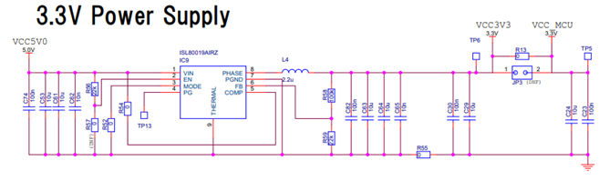

Evaluation Kit Power Domains
This kit has a good design for measuring microcontroller power consumption. The supply to the CPU can be isolated from any other consumer - such as LEDs, pullup resistors, etc ....
The net for all 3.3V consumers is called VCC_3V3. The net for the microcontroller supplies is named VCC_MCU.

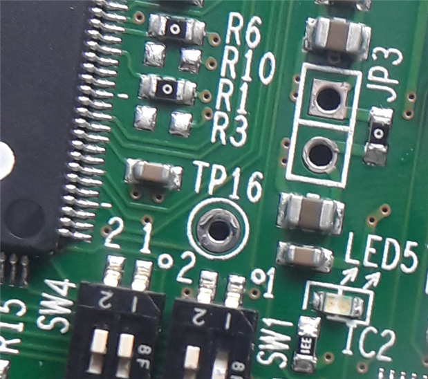

The 0Ω resistor R13 connects the two nets by default. There's a position on the board (JP3) to place a jumper.
source: Envision Kit schematic from Renesas

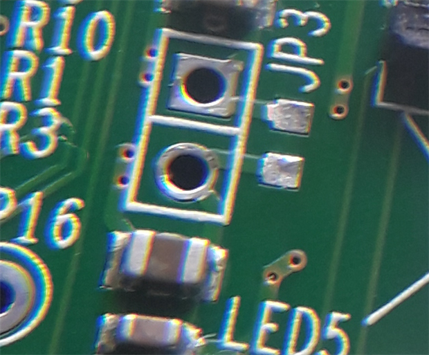

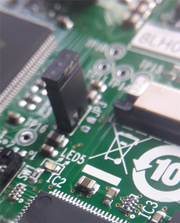

To prepare the board for current measurement, you have to remove R13 and place a two-pin header in the JP3 position. First remove the LCD.
attention: when you place the LCD back, put an isolation shield between the PCB and LCD.
The LCD back plane is conductive and can short out any trough-hole components.
When you're not measuring the current, place a jumper over JP3. The board will work as before.

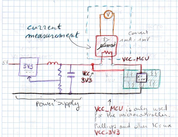

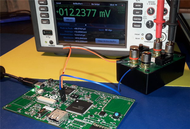

If you want to measure current, then remove the jumper and put a current meter over the JP3 pins.
This has to be a low-Burden-voltage meter, because the supplied voltage should not drop significantly below 3.3V.
I use an EEVblog µCurrent, as shown in the drawing below:

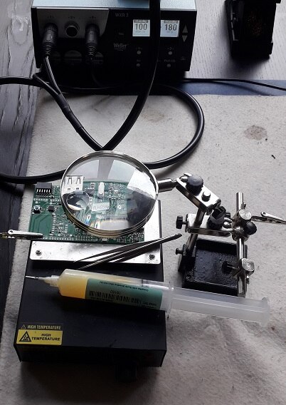

In this gallery, you can see the steps to remove R13 and place JP3.
Take care to not heat up the flatflex connector when removing  R13.
{gallery} Prepare the evaluation board for current measurement
Preparation:R13 has to be removed, JP3 populated
Preparation:Bench set-up
Rework: R13 is desoldered
Rework: JP3 Placed
Finished:Test bed ready for current measurement

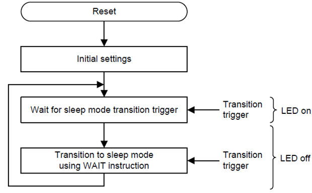

That part is very easy. The application note R01AN4347EJ0110 comes with example programs for several low power modes.
The one I'm using here is the Power Save Sleep design.

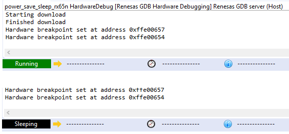

Compile and run.
You can see the power mode in the status bar of the e2 studio. Each push of the button, the design switches between default and sleep mode.
You'll also see that the LED is on in normal mode and off in sleep mode. Don't worry about power consumption. The power for the LED does not flow through JP3.
Measure the Power

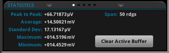

I've put the current measure circuit over JP3. That means that it's in series with VCC-MCU.

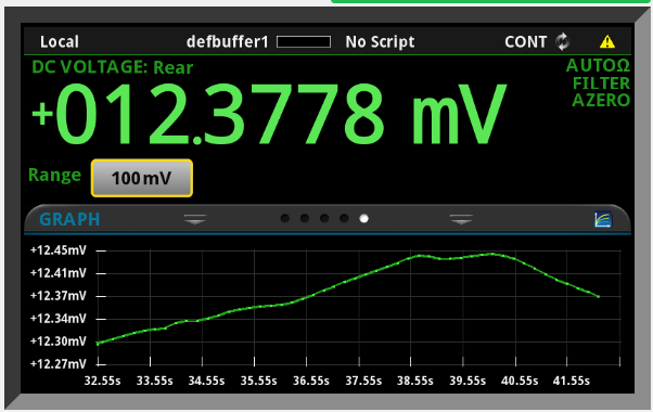

I've usd a µCurrent in 1mA == 1mV mode, so the measurements below have to be interpreted as mA measures instead of mV.

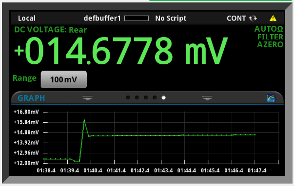

Normal mode:

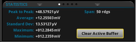

The current in normal mode is (average over 50 samples) 14.50021 mA. Voltage at test point 5 (VCC_MCU) is 3.3067 V. Power  is approx. 47.95 mW
In sleep mode, the current is 12.25503 mA. VCC_MCU is 3.3081. Power consumption 40.54 mW.
