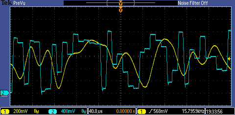

Here's how the output looks. The blue trace is the DAC output, the yellow the filter output. The filtered output is delayed somewhat [which, of course, is inevitable with an analogue filter].

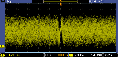

Here's how multiple, accumulated traces look; away from the trigger point, that looks quite satisfyingly noisy.

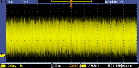

Here it is on a longer trace

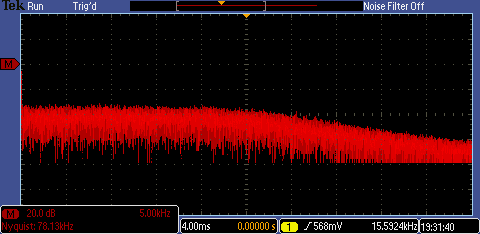

Finally, here's the best the 'scope can manage in the way of an FFT. This is accumulated over several seconds. The cut-off of the reconstruction filter is somewhere close to the centre of the screen, so the noise is roughly tracing out its response for me [roughly because the sin x/x response of the zero-order hold of the DAC will also be mixed in with it].
Below the cut-off, the spectrum is reasonably level, so there the numbers I'm generating approximate to 'white' noise.

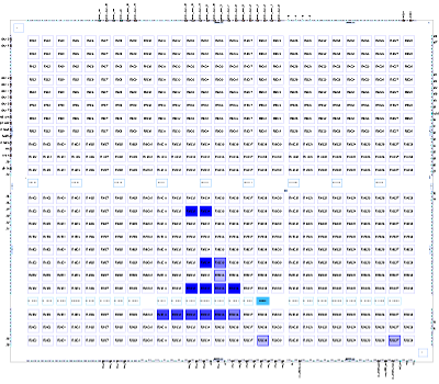

That was very quick and easy to do. It doesn't take many slices but it's quite expensive in one respect because it uses up one DSP block to build the 32 x 32 multiplier.
Trade Offs
Here is the floor plan using the hard multiplier in the DSP block (the 36x36 multiplier is the turquoise block).
   MULT36             1/3            33% used
   SLICE             49/2376          2% used

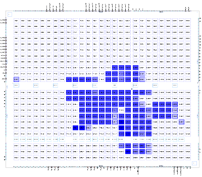

This, in contrast, is the floorplan if I ask IPExpress to build the multiplier from slices.
   SLICE            336/2376         14% used
