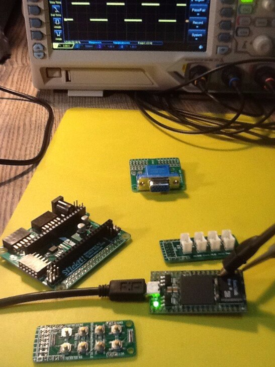

For a standalone XuLA2 board, talking to SD cards is a good practical example.
There's  a Micro SD slot on the XuLA2 models. The only other component you need is a spare Micro SD card.
Don't use an SD card with your marriage photo shoot on it. You'll very likely loose that when you test this project.

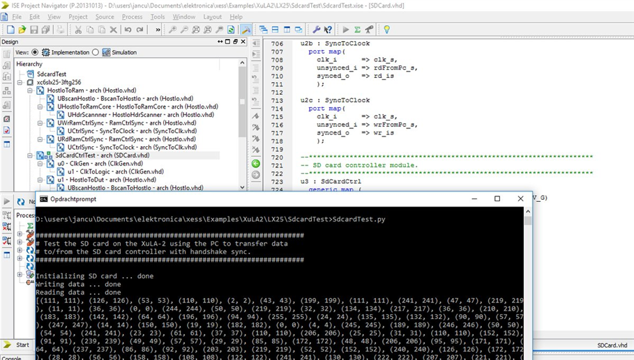

Open that file by double-clicking the u3 - SdCardCtrl node in the Implementation view.
If you've ever tried to understand (or port) a microcontroller SDCard lib - maybe the one from Arduino - you'll recognise much of the logic.
Let's now synthesize the project and generate the programming file.
Insert the SD card, connect the XuLA2 with your laptop and load the bitstream:
xsload --fpga sdcardctrltest.bit
Once you've loaded the bitstream, your XuLA2 board sits idle. You need to tell it to read and write data.
There's a python scrip that does exactly that.
If you have retrieved the latest XuLA2 FPGA sources from GIT, you'll find a python file named SDcardTest.py in the project directory.
If you're using the examples that were installed by the XESS installer, you can retrieve the testbed from here:
https://raw.githubusercontent.com/xesscorp/XuLA2/master/FPGA/SdcardCtrlTest/SdcardTest.py
Run the script to write a random set of data to the SD card, read it back and check if everything is correct:
SDcardTest.py

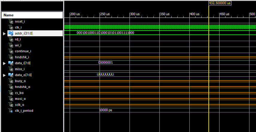

Windows 8 and Windows 10 with Xilinx ISE
If you are running WIndows 10 64-bit, you may encounter several ISE problems:
  • Pressing the Open Project button (and several other actions, like selecting the Preferences menu item) crashes ISE.
  • Running the Simulator results in a "failed to link the design" message and the simulator not starting.
Switching to the 32-bit version has solved most of them for me:
To switch,
  • alter the command in the ISE shortcut to
    "<DRIVE>:\Xilinx\14.7\ISE_DS\settings32.bat D:\Xilinx\14.7\ISE_DS\ISE\bin\nt\ise.exe"
  • in "<DRIVE>:\Xilinx\14.7\ISE_DS\ISE\bin\nt", rename fuse.exe to _fuse.exe, and copy the fuse.exe from the "..\nt64" directory over (got that from here)
After that, I still have one issue left: when in Simulator, the Relaunch functionality doesn't work. I have to close iSIM and restart it from within ISE.

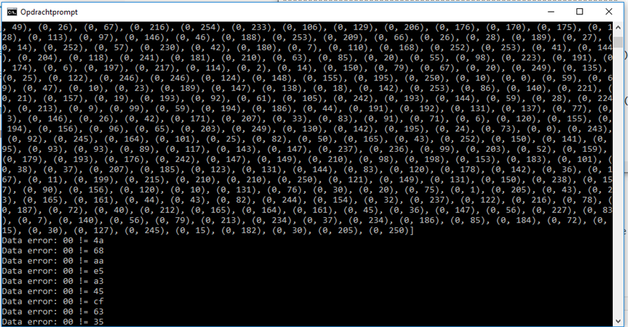

I've also tested the design with a known defect card - one that's rejected by any known operating system and can't be formatted.
This test was successful. The test flagged that the FPGA wasn't able to write data, as expected:
