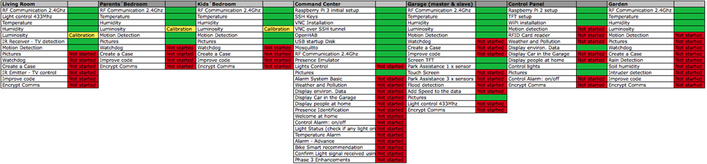

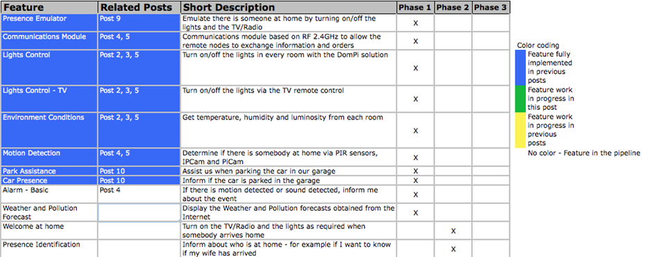

Let´s review the project status and jump into the details.
Previous Posts
PiIoT - DomPi: ApplicationPiIoT - DomPi: IntroPiIoT - DomPi 02: Project Dashboard and first steps in the Living room
PiIoT - DomPi 03: Living room, light control via TV remotePiIoT - DomPi 04: Movement detection and RF2.4Ghz commsPiIoT - DomPi 05: Ready for use Living Room and parents and kids´ bedrooms
PiIoT - DomPi 06: Setting up the Command Center - RPI3PiIoT - DomPi 07: Setting up the Command Center (2)PiIoT - DomPi 08: Setting up the Command Center (3) openHAB, mosquitto, RF24
PiIoT - DomPi 09: Presence EmulatorPiIoT - DomPi 10: Garage node (slave)PiIoT - DomPi 11: Ready to use. Garage node (master & slave)
Project Status

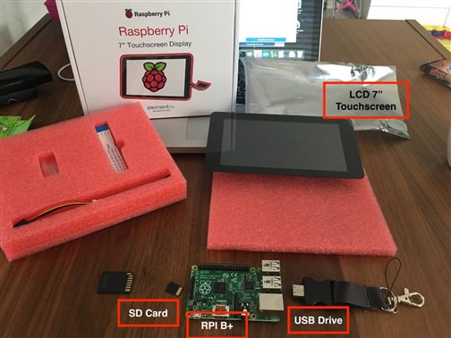

The HW architecture for this first development is quite straight forward: the Raspberry Pi B+, the LCD and the Wifi dongle, all of them come with The Kit of the Challenge. Really cool components that have been as easy to install as "plug-and-play".
Control Panel. Raspberry Pi set-up
First step has been to install NOOBS into a SD card I had at home. To do so, I just followed the instructions from the RaspberryPi webpage here and downloaded the latest OS version from here. It all went fine, with no call outs at all, including the first boot when the RaspberryPi gets auto configured. Once it finished booting and I was on the graphical interface I modified the RPI password - you never want to have the default password in a system like a RPI that can expose your network to the Internet if hacked... After that, I changed the name of the RPI to "controlpi" - to do so I went to Menu->Preferences->Raspberry pi Configuration and changed it there both the hostname and the password.
Next step has been to move the OS from the SD card to a USB drive. I just followed the same steps as I described in PiIoT - DomPi 07: Setting up the Command Center (2) These steps still work image In the Control Panel case, I also had to use /dev/sda7 as the place where the file /boot/cmdline.txt had to point at for booting on the USB. No call outs, no delays, again!

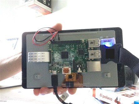

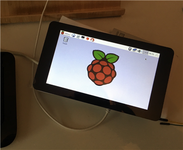

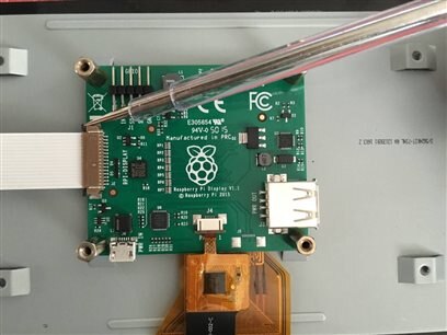

Control Panel. LCD 7" Touchscreen installation
Now it comes the fun and new part for me, to install the LCD! I was looking forward to it since the box came but didn´t have time till now, plus was concerned it´d be more challenging. So I started by following the instructions from Element14 here. All went really well!. Besides this page, more people in the Challenge have used it and I think it is worth to have a look at this video from rhavourdimage nice! I found the same comment as Rick´s that after installing the keyboard app, it did not appear in the menu. I just follow Rick´s solution:
After installing matchbox-keyboard, I still did not have a menu option for it. If that is the case for you, simply go into Menu->Preferences->Main Menu Editor->Applications->Accessories. Enable the keyboard by clicking its' "Show" option.
And it worked out. Thanks rhavourd!
Another comment, to plug in the DSI ribbon cable, the white one, I had some difficulties with the connector and didn´t want to damage it. I just carefully used  a screwdriver to unlock the connector and then lock it with the cable inside. You can see a picture of this and the final result here:

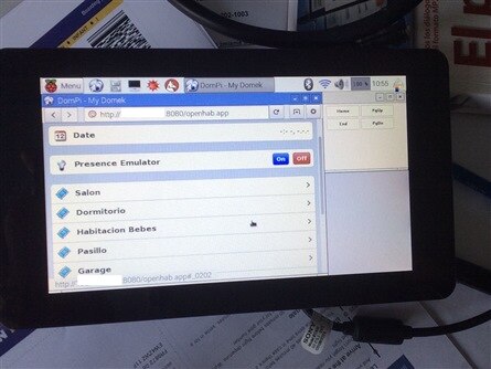

Control Panel. Final test with OpenHAB
As a final test, I want to display the DomPi status on the Control Panel screen. Firstly, I make sure that the OpenHAB server from the Post 9 is running and then I launch the Epiphany browser on the Control Panel and point it at the url: http://myCommandCenterIPaddress:8080/openhab.app and after crossing my fingers... Here we are! The page served by the openHAB app in my Command Center is displaying on the Control Panel and I can actuate on the lights and read the sensors! Phew image
Note that I have not installed the VNC server as I don´t plan to use it. Re the SSH keys as per my post 6, I do believe it is good to deploy them and plan to do it in the short term - I defer it right now as I won´t expose this RPI to the Internet and have already changed the pi password.
Control Panel. Launch browser on boot
This is the final step. I want the Control Panel to display the DomPi openHAB page whenever it is booted up. I could do this by creating a shortcut on the desktop and double clicking it whenever I power it up but... I thought of doing this automatically. To do so, I want to launch the Epiphany browser pointing at the previously shown url: http://myCommandCenterIPaddress:8080/openhab.app
I will install the matchbox-window-manager to allow me launch Epiphany in full screen mode:
sudo apt-get install -y matchbox-window-manager
The browser requires a /.config folder to store the cookies, etc. I had it already and did not precise to create it. Besides that, I have created a file that will be executed at boot time. I created this under /home/pi by:
sudo nano ./cpPi_bootEpiphany
and pasted these lines:
#!/bin/sh
xset -dpms # disable DPMS (Energy Star) features.
# xset s off # disable screen saber - I have commented out this line as I do want to have the screen to go off after inactivity
# xset s noblank # don't blank the video device - I have commented out this line as I do want to have the screen to go off after inactivity
matchbox-window-manager -use_titlebar no &
WEBKIT_DISABLE_TBS=1 epiphany-browser -a --profile /home/pi/.config http://commandcenter_IPAddress:8080/openhab.app
I just replaced the CommandCenterIPaddress by the right address
Finally, I added this line to the /etc/rc.local file putting them before the exit 0 line:
sudo xinit ./home/pi/cpPi_bootEpiphany &

Nodes´ Dashboard
I added the Control Panel node for the first time in this post - it would have hindered the readability before...
More lines coming into green!
