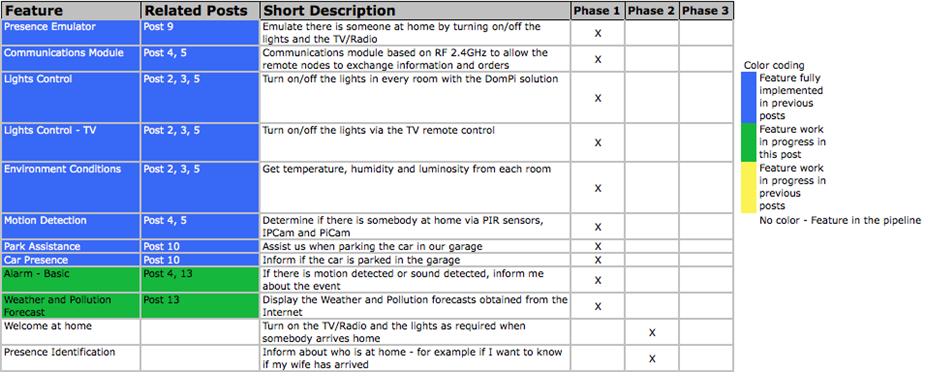

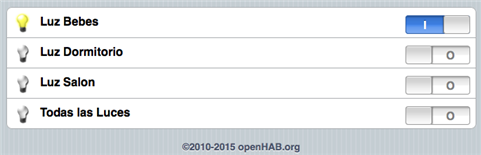

Trying to move full speed during the last two weeks of the challenge! In the last few days I have achieved a great milestone in the DomPi project: all the features from the Phase 1 are now fully operational image. The missing pieces that I worked out these days have been:
  • finalize the C module that acts as a gateway between the remote nodes (via the RF 2.4Ghz comms module) and the Command Center (with the Mosquitto channels). This was already quite advanced, but now it should be the final version

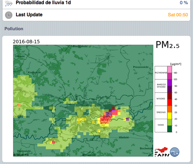

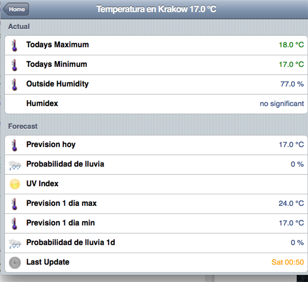

  • Weather and Pollution forecast. Display weather and pollution information

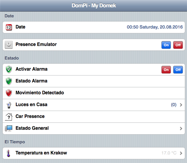

  • Alarm - Basic. Implement a basic alarm system that detects movement at home and triggers an action
Let´s have a quick look at the current Project Status and go to the details!

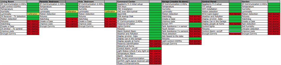

Project Status

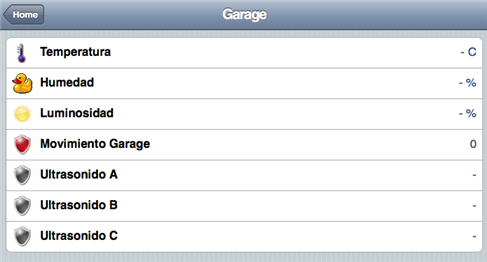

Garage5
Temperature, humidity, luminosity and movement
Ultrasonic distance from the rear wall to the car
Future: two more ultrasonic distances (lateral walls), flood detection
Force_send_message
Get if car is in the garage

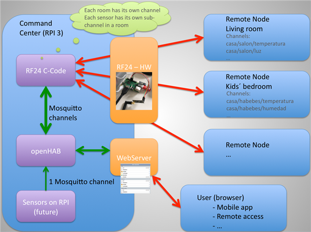

In the said post, I shared some details of the protocol and how the C gateway works. Let me just focus on this post on some details not covered at that time. The RF communication is based on three types of messages as seen in the picture below. There will be a forth type of message once the Garden node is expanded to be able to send the rain drop and moisture data.
On the Mosquitto side of things, each room or smartspace publishes and receives data through its own Mosquitto channel. For example, the living room gets and sends data via /casa/salon/... Within the room, each sensor and actuator again sends or receives data via its own channel: the temperature in the living room uses /casa/salon/temperatura. This approach much easier to expand the project and also to test and debug it since you keep all of the components independent from each other. Then openHAB will manipulate the data as required.
The C code can be found below. Please note the comments from the previous post on how the code is written as well as the required Makefile to successfully compile it in the Raspberry Pi.

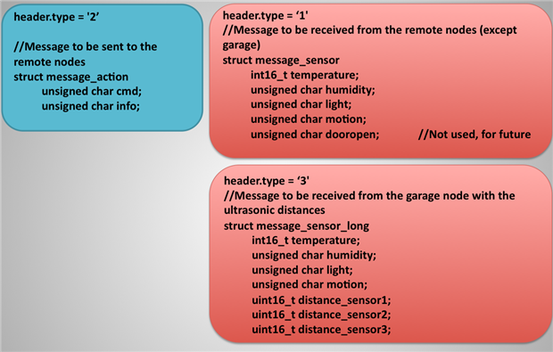

// Structure of our messages
//Message to be sent to the remote nodes
struct message_action {
    unsigned char cmd;
    unsigned char info;
//Message to be received from the remote nodes (except garage)
struct message_sensor {
    int16_t temperature;
    unsigned char humidity;
    unsigned char light;
    unsigned char motion;
    unsigned char dooropen;        //Not used, future purposes
//Message to be received from the garage node with the ultrasonic distances
struct message_sensor_usonic {
    uint16_t distance_sensor1;
    uint16_t distance_sensor2;
    uint16_t distance_sensor3;

        while ( network.available() ) {
            RF24NetworkHeader header;
            // Have a peek at the data to see the header type
            network.peek(header);
            // We can only handle type 1, 2 and 3 sensor nodes for now
            //    Type 1: temperature, hum, luminosity, motion
            //    Type 2: cmd and info
            //    Type 3: as type 1 plus the 3x ultrasonic sensors - mainly for the garage
            if (header.type == '1') {
                // Read the message

            } else if (header.type == '2') {
                message_action actionmessage;
                network.read(header, &actionmessage, sizeof(actionmessage));
                unsigned char cmd_rx = actionmessage.cmd;
                unsigned char info_rx = actionmessage.info;
                printf("Message received from node %i header type 2. Cmd: %i Info:%i\n", header.from_node, cmd_rx, info_rx);
            } else if (header.type == '3') {
                message_sensor_usonic sensormessage;
                network.read(header, &sensormessage, sizeof(sensormessage));

As a high level summary of how the C Gateway module interacts with the rest of DomPi, a quick summary of the blocks (as shown in post 8).
Weather forecast
For this feature, as well as the Alarm later on, I changed the approach from using more C modules. As discussed in post 9, openHAB has quite a robust rule machine that I am leveraging. This means that I am struggling to keep the right pace of the Challenge while learning the best practices of programming in openHAB... The result is that very probably the code you will find here for the items, sitemap and rule files of openHAB won´t be as neat, optimized and adequate as I´d like to... Despite all this, I do believe that giving the openHAB a try is the right thing for DomPi.
OpenHAB has a binding, Weather-Binding, that helps out on gathering weather information from a set of seven providers in the Internet and show them in your project. In my case, I have selected the Yahoo one as it is simple to use, does not require any registration and includes most of the weather data I am looking.
These providers usually limit the number of times that your IP can ask for an update. This provider is also ok on this - in any case, the weather forecast does not change more than a few times a day.
To use Yahoo, the first step is to locate the where on Earth ID - woeid. Yahoo no longer uses GPS coordinates but the woeid. I found out my city at woeid.rosselliot.co.nz/ It was 502075 for the City of Krakow, Poland. Then I copied the weather-binding into the /openhab/addons folder so that it can be utilized. The last step is to update the openhab.cfg to configure the weather-binding. By "sudo nano openhab.cfg" I modified the following lines, I did have to scroll down a lot, looking first for the Bindings section and then for the Weather Bindings.
# location configuration, you can specify multiple locations
# Note: latitude and longitude are NOT required for Yahoo
#       woeid is ONLY required for Yahoo
weather:location.home.name=Krakow
#weather:location.<locationId1.latitude=
#weather:location.<locationId1>.longitude=
weather:location.home.woeid=502075
weather:location.home.provider=Yahoo
weather:location.home.language=en
weather:location.home.updateInterval=20
The last line establishes a 20 min refresh.
After these steps I was able to partially get the weather data I was looking for, but not all of it. For example, I didn't have the UV index or the forecast for tomorrow. After some trials and different attemps, I ended up running the binding in the Debug mode so that I could see what I was getting from the Yahoo server. To do so, I followed the instructions here, I added this line to the file logback.xml:
<logger name="org.openhab.binding.weather" level="DEBUG" />
With this, I have been able to fine tune it and I am getting tomorrow´s forecast (I was calling the "current" temperature and... well there is effectively no "current" temperature for the future image ). However, I have not yet been able to receive teh UV index. From the debug mode it seems, Yahoo does not provide it, so I might change the provider in the future.
Pollution forecast
In my current city, we have problems with the high pollution, specially during Winter time. Since I like biking to work, I am very interested in knowing how bad is the pollution and decide whether to use a mask or don´t bike that day. There are some webpages that provide different ranges of data. I have selected this one.
How does it work? To display the pollution forecast, there are two steps. Firstly, DomPi downloads the pic from the web server and stores it in a specific folder with always the same file name. Secondly, openHAB looks for this file name and displays the image. Let´s have a look to the details:
  • Download the picture. This is achieved by the rule "Download image of pollution" in the rules file of my project. Basically, every day at 6:00 am it request from the above server the daily image that shows visually the forecast for the pollution levels. The name of the image changes everyday, but the format follows always the same approach: http://www.smog.imgw.pl/home/images/krakow/PM25/fapps_map_krakow_1km_2016_m08_d20_0000_pm25_24hr.pngyou can easily detect that what changes is the year, month and day. The above openHAB rule imitates this pattern and daily it changes based on the current day.  To download the picture, I use the executeCommandLine function in openHAB, which allows you to run commands as if you where in a terminal window. The command I run is "curl" and it stores the downloaded image always in the same folder and with the same name: webapps/smgimg/contaminacion.png. The rule code is:
when
    Time cron "0 0 6 * * ?"    or    //Download pic every day at 6am
    System started                //or when the system starts
then
    //First step we create the correct file name. It consists of the year, month and day
    val String s1 = "curl@@-o@@webapps/smgimg/contaminacion.png@@http://www.smog.imgw.pl/home/images/krakow/PM25/fapps_map_krakow_1km_"
    val String s2 = "_m"
    val String s3 = "_d"
    val String s4 = "_0000_pm25_24hr.png"
    val yr = now.getYear                                    //Get current year, no zero padding
    val mt = String::format("%1$02d", now.getMonthOfYear)    //Get current month, zero padding
    val dy = String::format("%1$02d", now.getDayOfMonth)     //Get day, zero padding
    say("Skipping download of the pollution image!")
    var result = executeCommandLine(s1+yr+s2+mt+s3+dy+s4)
end
  • Display the image. It is important that the image has always the same name as I have not been able to find out in google how to link a dynamic picture within an item. But it is quite easy to show any image with a fixed name, I found quite useful this post in the openHAB forum. I display the image with the below line in the sitemap file. The refresh parameter reloads the image every 15 mins. It won´t change that often, actually just once a day, but I have not found out yet how to sync the rule with the sitemap and just get it refreshed when needed.
Image url="http://localhost:8080/smgimg/contaminacion.png" height=10 refresh=900000
And below you can see what is the output in openHAB.
This image is quite neat and will help me decide if it is a good day for biking or better not to risk the health of my lungs...
Alarm - Basic
The final feature for the Phase 1 is the Alarm. Due to time limitations, I am focusing on the basic requirements of an alarm: activate and deactivate it, trigger the alarm if movement is detected by sending an email, allow some seconds (60 sec) after the alarm is activated to let me go out from home, allow another 60 secs before triggering the alarm in case I am entering home to have time to deactivate it.
Once again, I am using the openHAB rules to implement all of this instead of C modules. The alarm feature is governed by 7 rules and 4 items in DomPi. It´d be quite lengthy to explain all of them in detail in the post so I will focus on the main points of it and you can always review the code and the comments in the openHAB files attached.
The main rule is called "Check motion sensors". OpenHAB allows lambda expressions so checking if any motion sensor is active is quite simple:
gMotions.members.forEach(motionsensor|
        if(motionsensor.state==1) mov_detected = true        //if any of the sensors is 1, we modify the variable
The output of the rule is an update on the item called Nodo09MotionDetected, it will turn it ON or OFF. This output is the trigger for the next rule, called "Check if to trigger Alarm - Motion detected PIR". If the Alarm is active, this rule will update the item Nodo09AlarmStatus and turn it ON.
Finally, the rule "Trigger Alarm" comes into play if the item Nodo09AlarmStatus was moved from OFF to ON. This rule checks if we are still waiting the 60 secs after the user pressed the button to activate the alarm (as a reminder, I am giving myself 60 secs to leave home). If we are out of those 60 secs, it starts a timer and counts yet another 60 secs before triggering the alarm: I want to give myself this time if I am entering home to be able to deactivate the alarm.
For easiness, here is the code for these 7 rules:
 * Rules related to the Alarm
 *     Check motion sensors
 *     Check if alarm needs to be triggered
rule "Allow time after alarm is activated"
//Allow 60 secs to leave home before raising any alarm
when
    Item Nodo09AlarmSwitch changed from OFF to ON
then
    timer_alarm_activation = createTimer(now.plusSeconds(60)) [|
        //Once time passed, we just remove the timer. The rule
        //for triggering the alarm will just check the timer status
        if (timer_alarm_activation!=null) {
            timer_alarm_activation.cancel
            timer_alarm_activation = null
        postUpdate(Nodo09AlarmStatus, OFF)        //After the 60 initial secs reset the Alarm status
        postUpdate(Nodo09MotionDetected, OFF)    //After the 60 initial secs, reset motion detection
end
rule "Turn off timer if alarm deactivated"
//If alarm is turned off while the rule "Allw time after alarm is activated" is
//on hold with the timer, this cancels the timer
when
    Item Nodo09AlarmSwitch changed from ON to OFF
then
end
rule "Check motion sensors"
when
    Time cron "*/2 * * * * ?"         //We check motion sensors every two seconds
then
    mov_detected=false
        if(motionsensor.state==1) mov_detected = true        //if any of the sensors is 1, we modify variable
    //To avoid continuous update of Node09MotionDetected, we only update it if the status has changed
    if (Nodo09MotionDetected.state!=(if(mov_detected) ON else OFF))
        Nodo09MotionDetected.postUpdate(if(mov_detected) ON else OFF)
end
//If button pushed to force the alarm, wait 15 secs and stop it
rule "Trigger Alarm - Forced"
when
    Item Nodo09AlarmForce changed from OFF to ON
then
    Nodo09AlarmStatus.postUpdate(ON)
    timer_alarm_forced = createTimer(now.plusSeconds(15)) [|
        Nodo09AlarmStatus.postUpdate(OFF)
        Nodo09AlarmForce.postUpdate(OFF)
        if (timer_alarm_forced!=null) {
            timer_alarm_forced.cancel
            timer_alarm_forced = null
end
rule "Check if to trigger Alarm - Motion detected PIR"
when
    Item Nodo09MotionDetected changed from OFF to ON
then
    //If the alarm is active, then modify the Alarm Status to ON and ring the Alarm
    //If the alarm is deactivated, do nothing
    if(Nodo09AlarmSwitch.state==ON) {
        alarm_report_send_email = "Motion detected now in room X"        //prepare report to send per email
        alarm_report_internal = "Alarm!!! Motion detected and Alarm not deactivated within 60s"
end
//First wait 60 secs and check again that there is a status of alarm, this will avoid false alarms
when
    Item Nodo09AlarmStatus changed from OFF to ON
then
    //if timer_alarm_activation is null, this means that the alarm was activated
    //and the 60 secs allowance to leave home have ellapsed, therefore, we should trigger the alarm
    if (timer_alarm_activation==null) {
        say("Allowing 60secs before triggering alarm")
        timer_alarm_trigger = createTimer(now.plusSeconds(60)) [|
            //Check again status of the Alarm before triggering it
            if (Nodo09AlarmStatus.state==ON) {
                say(alarm_report_internal)
                //sendMail("mg.serigop@gmail.com", "DomPi - Alarm. Motion detected", alarm_report_send_email)
                say("SendMail deactivated")
            } else say("Alarm deactivated. False Alarm")
            if (timer_alarm_trigger!=null) {
                timer_alarm_trigger.cancel
                timer_alarm_trigger = null
                alarm_report_internal =""
                alarm_report_send_email=""
    } else {
        say("Alarm not triggered - we are still within 60 secs from activation")
end
rule "Cancel Trigger Alarm"
//Cancels timer for the alarm trigger
when
    Item Nodo09AlarmStatus changed from ON to OFF
then
end
