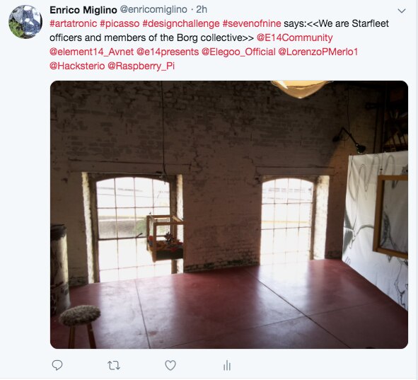

Thanks to the class library that pragmatically manages all the dirty job of initiating the twitter communication, connecting and sending the tweet message, the Python command to send periodically tweets is very simple and the library can be reused by other Python commands that will use Twitter messages in other contexts.
#!/usr/bin/python3
from pyclasses.twitter import SevenOfNineTwitter
from picamera import PiCamera
tweet = SevenOfNineTwitter()
tweet.connectTwitter()
camera = PiCamera()
camera.capture("/home/pi/images/twitter.jpg")
tweet.tweetGeneric(True)
The command before calling the SevenOfNineTwitter class to send the tweet captures an image, overwritten always with the same name. the tweetGeneric() method of the class to the rest. Also, this command has been added to the crontab scheduler to execute recursively. Below some examples from my account Twitter feed.
#artatronic #picasso #designchallenge #sevenofnine says:<<Info assimilated>> @E14Community @element14_Avnet @e14presents @Elegoo_Official @LorenzoPMerlo1 @Hacksterio @Raspberry_Pi pic.twitter.com/Lk8z2FM2cH
— Enrico Miglino (@enricomiglino) April 21, 2019
#artatronic #picasso #designchallenge #sevenofnine says:<<I get it, loud and clear>> @E14Community @element14_Avnet @e14presents @Elegoo_Official @LorenzoPMerlo1 @Hacksterio @Raspberry_Pi pic.twitter.com/zI1Apot2aH
— Enrico Miglino (@enricomiglino) April 20, 2019
#artatronic #picasso #designchallenge #sevenofnine says:<<I can change my shape>> @E14Community @element14_Avnet @e14presents @Elegoo_Official @LorenzoPMerlo1 @Hacksterio @Raspberry_Pi pic.twitter.com/XM9OcKad1v
