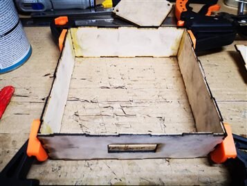

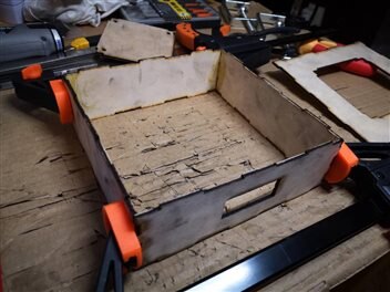

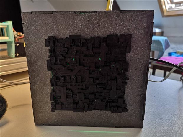

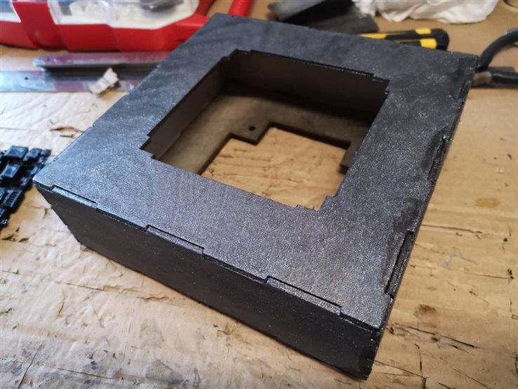

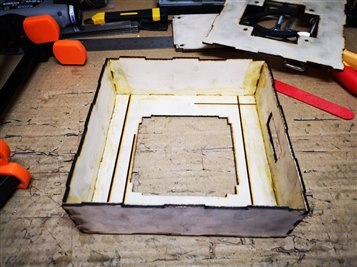

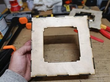

The first step was building the container. Thanks to 3D printer and laser cutter it was possible to recreate an object resembling the Borg terminal
Above: the four sides of the terminal box (laser cut) glued together. The rectangular hole is the side where I will connect cables and probes to the internal electronics.

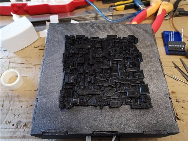

Below: The front side glued to the frame. This side will host the Borg plate, resembling a face of the Borg Cube starship. I have 3D printed it with the Elegoo Neptune 3D printer set to a Z-axis resolution of 0.06 mm per layer for the better quality of the details of the surface.

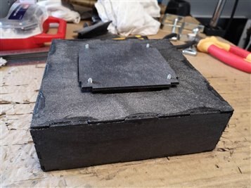

After assembling the essential parts of the case, the next step has been to create a box that can confuse Borgs. As shown in the images below, I have painted the assembled terminal case with metal black paint embedding nanodrones, to create a camouflage effect for the Borg sensors in case they discover where I am.

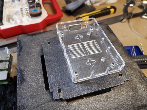

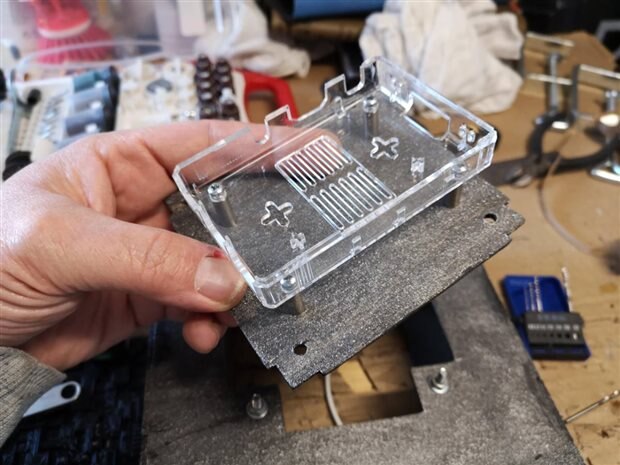

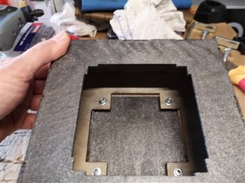

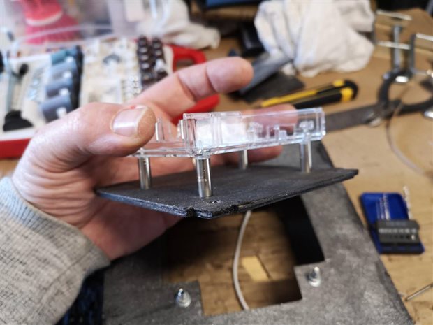

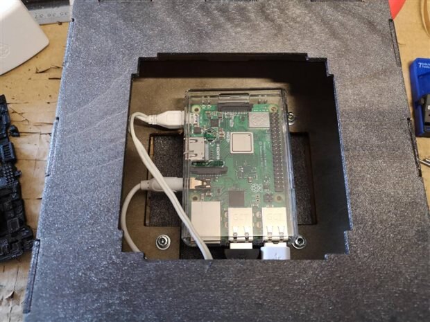

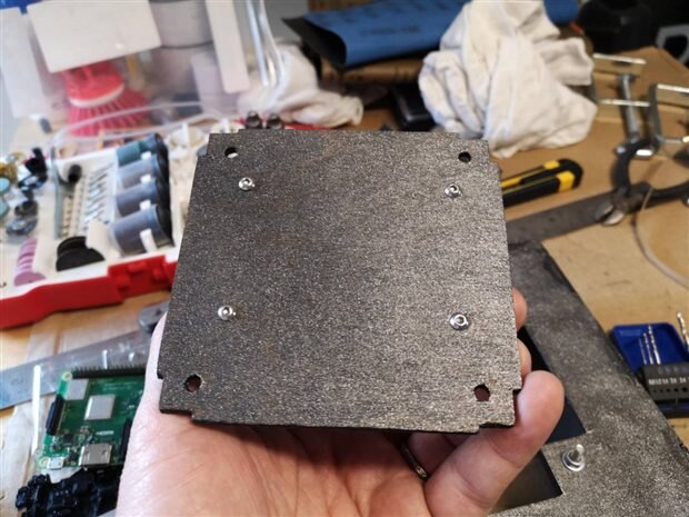

The back side will keep firmly the Raspberry PIRaspberry PI headless Brain Module so it can be inserted in the case and kept suspended in the middle. This is to avoid reaching too high temperatures due to the effort of the processor. The back side does not close completely the box so the green radiations – another camouflage effect – are emitted from the entire device.
The PI Inside

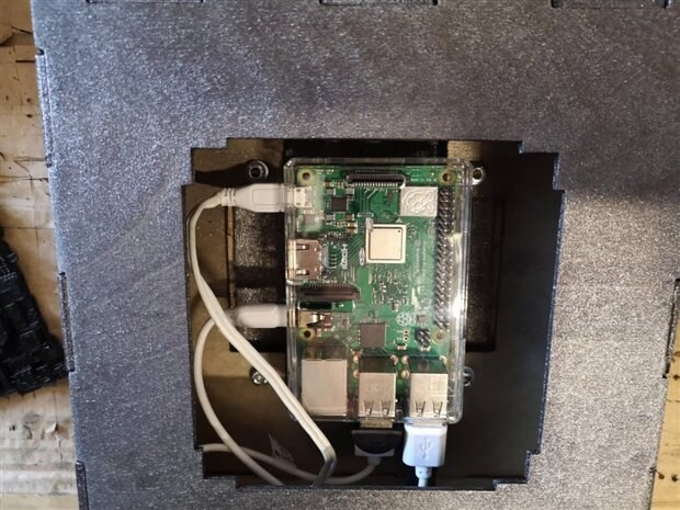

The procedure to install is almost complex, at least the first time. While the board is kept in place by the back side, the connection should be inserted until the front side is open.
{gallery} Raspberry PI Inside
The Raspberry PI case suspended to the internal side of the back cover of the box
How the backside cover appears with the PI board inside
The PI is exactly centered to the middle of the box
The PI can be inserted to the back without the connections

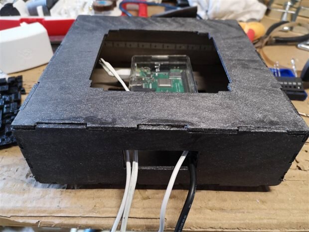

After closing the back side, the connections and power are inserted from the side keeping the front of the box open
Power and audio out can't be inserted from the box side
After assembling the terminal all the cables are accessible from the open side.
The last step closing the front side with the 3D printed plate
The Borg Communication terminal complete. First power-on
