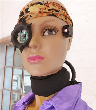

Maybe this episode is one of the less and intriguing than the previous ones in terms of spectacularity but this step was one of the most challenging.
After I have accomplished the task – that is, in a few words, <<Seven Of Nine extends to the social network>> I learned interesting new knowledge and acquired a new experience so I decided to share it dedicating an entire episode. Episode14 covers over one week of work on the Picasso Challenge to add new behavior to Seven Of Nine, extending the Borg ability to interact with humans beyond the borders of the exhibition location.
I say, in this episode, our animatronic has gone Where no man has gone before...

As discussed in Art-a-Tronic Episode 11 Tweepy is a complete Python library wrapping the Twitter APIs, already used with success. So, why not? In fact, Tweepy also includes the wrapper methods for sending and receiving Twitter Direct Messages. Unfortunately, the only calls that are not working are just those I need. Each tries to send a Direct Message I always get the Twitter returning error This page does not exist ( image ) on the terminal.

Digging in the Bug list of the Tweepy GitHub repository I discovered the reason the DM methods no longer work.
By the mid of July 2018, Twitter changed and strongly redesigned the Direct Message API endpoint disabling the REST approach, replaced by a different set of parameters to be sent through a POST call to the web.
Thanks to the community contributors and their suggestions I have found a couple of notes explaining a workaround to revive the sned_direct_message() call. The Direct Messages API features are available on the Twitter Developers Documentation.

I have modified the source files api.py and binder.py accordingly to the suggestions mentioned in the bug list and creating an updated send_direct_message() method that finally worked!
At that point, the account Seven Of Nine was able to send DM to any follower, also followed by the account. Then?
The updated Tweepy package was able to send DM but unfortunately, the same Twitter API changes on the DM API affected also the other methods related to Direct Messaging. I have tried to understand the logic of the new API POST procedure – that replaced the previous REST call – patching also the other Tweepy methods. After hours of tests and changes, things were working better but I was again experiencing some issue, and messages reply were not yet possible. I launched a call for help to the small group of Element14 members I already contacted some days before for testing the new chat feature (as it were available).
Lucky me image  Shabaz and Andy Clark answered to my request in less than an hour image
We three, trying and chatting, and discussing the results spent almost the entire Friday afternoon (just when normal people stop working and relax while the weekend is coming); during the night Shabaz found another version of the Tweepy package. A fork by another community volunteer able to produce a list of the last messages in chronological order, a Python list of JSON objects, accordingly with the Twitter's API specifications.
Problem solved? Not yet. But Almost!
After further testing, we were sure that this new version was working fine, but not for the send_direct_message() method. I tried to proceed. pragmatically:
  • Forked the last, partially working repository on my GitHub account
  • Applied the fix (again) to the send_direct_message() method
  • Installed the package and tested it
Finally, I saw the magic! Sending DM and receiving responses was a reality, no matter what side initiate the conversation. The updated Tweepy package working fine with the new Twitter Direct Message API (send and receive) is available on GitHub under the same MIT license as the original version: https://github.com/alicemirror/tweepy
