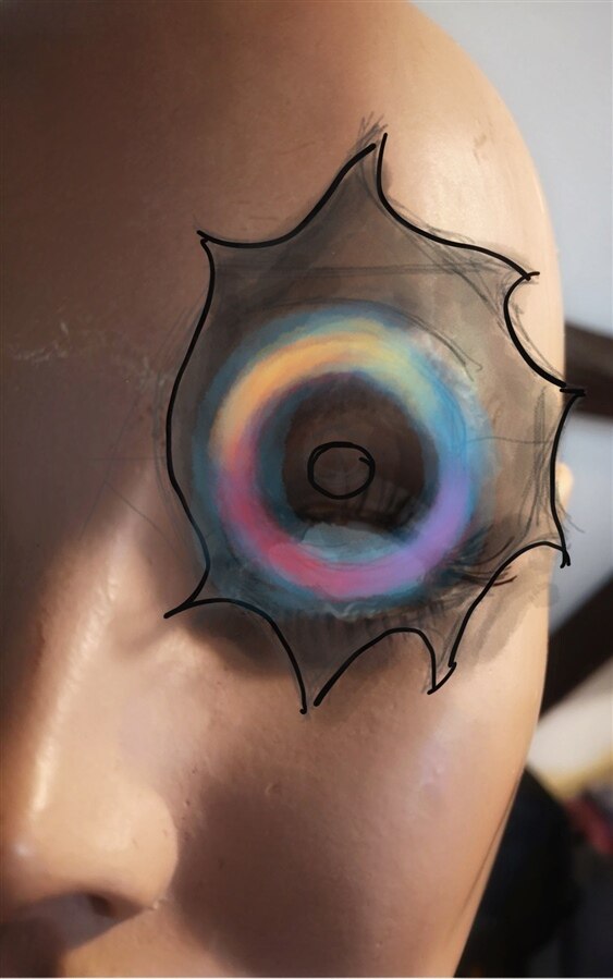

    Looking good (except for the picture with the missing eye, that was kind of creepy). The stepper motor seems to hum throughout the mannequin, have you thought of some sound deadening material? Keep up…
    balearicdynamics over 7 years ago in reply to genebren +5
    Hello Gene, about the loud, considering that the body does not move compulsively but has a certain logic, can be reduced but I have kept it just because it is part of the scenery. To be honest, I have…

    balearicdynamics over 7 years ago in reply to dubbie
    Hello Dubbie,
    Thank you for the question. The left eye (you now see empty) is an implant below there is the sketch I am 3D printing. It will contain the PI Camera and around another emotional expression (no rainbow) with a NeoPixel ring.
    To make some intervention to the right eye there are two possibilities. The first is a small LCD that is the most realistic but considering the entire design of the system I will leave for last, at the moment I have no idea of what can be used to reach this scope. But - I repeat - it has a certain sense. More realistic will be a white ball but in this case, I should make the intervention with a lot of care as if I use a typical ping-pong ball and a rotation serve the result is just a scary machine like a Halloween project. And this is not what I want to achieve. It is a previous (and unique) vintage object where interventions should improve and in some way change the eve of this mannequin without compromising its own Original fascination.
    The eye is fixed but created with a lot of artistic effort, it seems really live and any change removing it with this natural translucent effect (it is not a design, it's a sort of acrylic covering over a hand made paint) is a pity in my opinion. At least I do not find a way to replace it with something very similar and moving. The try I will do instead is creating a shades/light effect with light from inside. I think this is more interesting.
    What do you think?
    I am also doubtful if the back head will be closed with the original piece or if it is better painting it with metallic paint. Probably I will leave it as-is.
    Enrico

    dubbie over 7 years ago in reply to balearicdynamics
    Enrico,
    I understand now why the eye was missing. I am sure you will come up with something good.
    One animatronic head that I was associated with (regretfully none of it was my design or construction) used prosthetic glass eyes, which look just like the real thing. Below is a link to actual glass eyes
    https://www.bbc.co.uk/news/magazine-17126713
    but these would very likely be very expensive. I am sure that there must be cheaper alternatives. It was some years ago now but I was shown a catalogue of several pages of different types of artificial eyeball, all different colours. When two eyes were installed in the head, which was just a wire frame outline and connected to move up/down and left/right using servos, it was freakily realistic. As people we are obviously attuned to look for the eyes in a face and can blank out the rest of the face or non-face as in my experience.
    Dubbie,
    it is what I thought but I have not tried to find it... A realistic eye is the worth, totally different than the classic Halloween ball.
    So, to make the story short, you have convinced me and I decided to give a try.
    Includes the support on the back, not stupid red veins and very nice.
    Enrico
