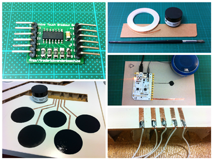

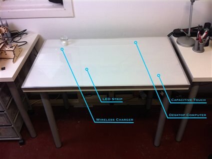

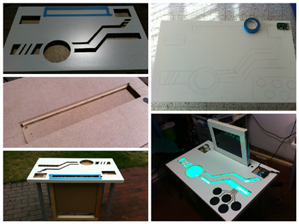

The collages represent different parts of the project in different stages. The final result is unveiled at the end of this post. To summarise though, the goal was to create a futuristic desk. I did so by integrating things such as LEDs, a wireless charger and capacitive touch controls inside the desk. There is even a computer that pops out of the desk when the correct button is touched!

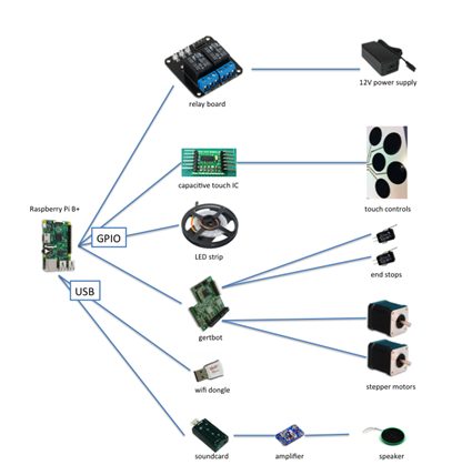

I made these image, trying to illustrate how everything fits together and interacts:
From left to right, top to bottom, we have:

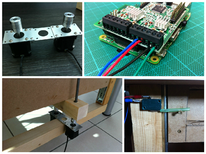

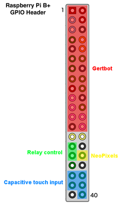

  • Raspberry Pi B+: This is the heart of project PiDesk, as it is in charge of controlling all the different components involved in the project. I originally opted for the Raspberry Pi A+, but was forced to move to B+ as the workaround required to have both audio and neopixels work, required a USB sound card.
  • Dual channel relay board: The relay board is controlled by the Raspberry Pi GPIO pins. It makes it possible to turn a 12 power supply ON or OFF, powering the laptop display, and a 5V power supply for the Raspberry Pi 2 desktop computer.
  • Capacitive touch IC (AT42QT1070): The custom breakout board is used to convert Raspberry Pi GPIO pins into capacitive touch input sensors. The touch sensors have been created using copper tape and conductive paint.
  • LED strip (WS2812): The LED strip is controlled by the Raspberry Pi and has been built into the desk's surface. It displays animations depending on the ongoing action.
  • Gertbot: The gertbot has two functions: raising and lower the screen assembly by controlling two stepper motors, and knowing when to stop using end stops.
  • Wifi dongle (WiPi): Wifi connectivity, mainly used during programming and testing.
  • Soundcard with amplifier (PAM8302): Play sound effects depending on the action to be executed.

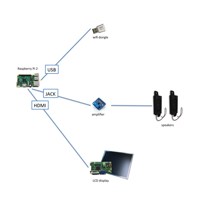

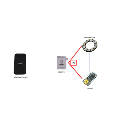

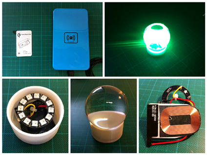

The pictures above represent on one side, the Pi 2 desktop computer, on the other, the magic lamp. As you can see, these items are very straightforward compared to the desk controls and require very little explanation.
For the desktop computer, a Pi 2 is used in combination with a recuperated laptop screen for which a controller board was found. A combination of a stereo amplifier and speakers are used for sound.
As for the magic lamp, a Trinket microcontroller and NeoPixel ring are powered via a wireless receiver. The circuit is powered on when placed on top of the wireless charger.

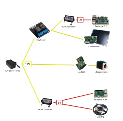

Power distribution
The main power supply is a beefy 12V one. It is used to power the stepper motors via the Gertbot and the LCD screen via the controller board. The other components of the project require 5V, which is achieved using DC-DC converters. The 12V input to the desktop components (Raspberry Pi 2 & LCD controller) are interrupted by a relay which is controlled by the Raspberry Pi B+. Two channels have been foreseen, although only one is currently in use.

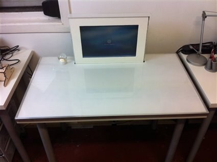

Finally, the "moment supreme", the moment you (may) have been waiting for, the final result.
Because it wouldn't be a real demo without an actual video, here it is. The first part is a montage of various stages of the build, followed by some demonstrations.
