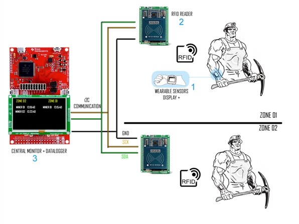

Brief Project Proposal Overview:
My Project Proposal was to design a wearable device which will be mounted on the wrist of the Miners to collect and display environmental information and develop an RFID based system to track the location of the miners.
System components -
  • 1. Wearable device mounted on the wrist of the miner

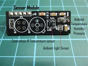

    • sensors -
      • ambient light
      • ambient temperature
      • atmospheric pressure
      • relative humidity
      • contact-less IR temperature sensor to measure object temperature
    • TFT display unit
    • Battery charger and PSU
  • 2. RFID 13.56MHz tag reader to detect valid ID of the miners
    • it will be placed at the entry of the working zone
    • miners have to punch their tags during entry
    • at detection of valid ID it will display the miner's profile
    • send the miner's ID and working zone ID with entry time to the central monitor
  • 3. Central monitor will collect miners' location for all the RFID device placed at different zones, and log it for future investigation.

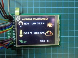

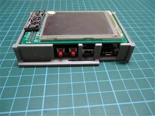

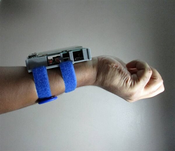

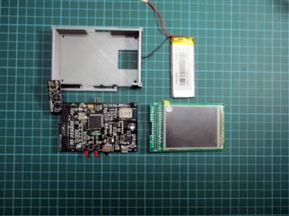

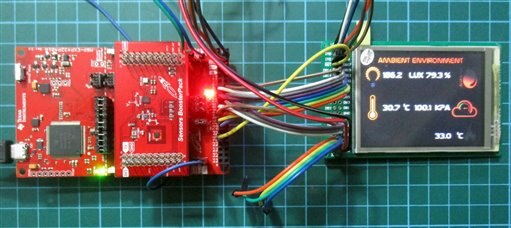

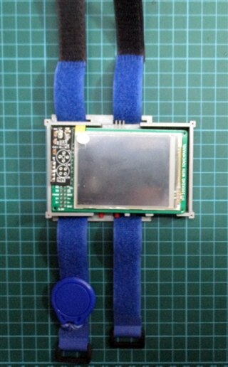

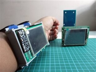

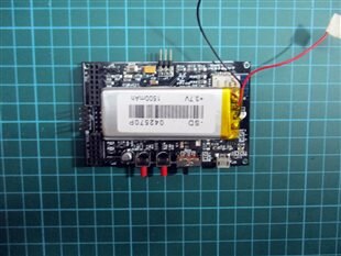

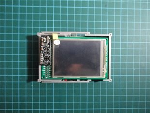

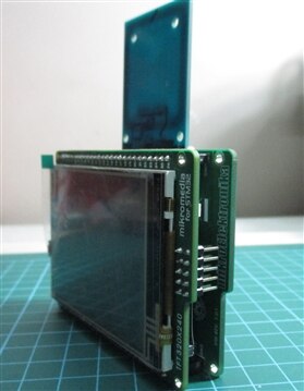

1. The wearable device:
Experimental Setup and sample display output - demonstration can be found in this blog [12: Integrating 3 sensors in firmware]

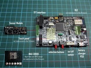

Final product - I have not populated some of the components those are not needed for this project proposal [like the TFT touch panel interface etc.]

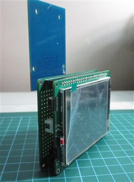

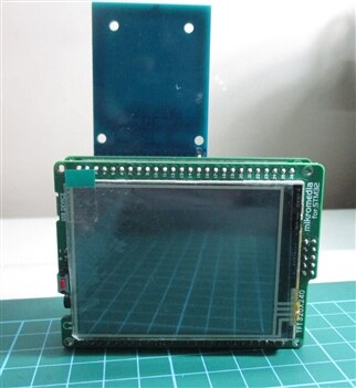

2. RFID Reader to locate Miners: demonstration can be found in this blog [14: RC522- reading RFID tags]

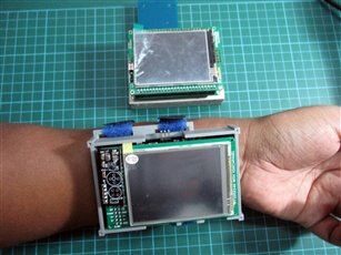

Both the devices together:
3. Central Monitor:
I am still working on this part of the system. I'll carry it on and post my updates later on..... may be after the submission deadline image
