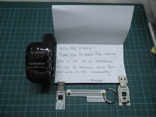

UPDATE:
A few days back I have received a gift from Element 14 to participate in this design challenge. It's a eZ430 - Chronos Development Tool from TI.
There was also a thanks giving note ..... image
