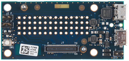

I purchased an Intel Edison when they first appeared (actually before they were in stock), and they were in the early days.
I quickly found that in order to even power it, you needed another board.
While it has WiFi and Bluetooth on board, the GPIO is 1.8v, which means you need level converters to interact with external devices.
Hence it sat waiting for a better time.
This challenge was the catalyst for firing it up, and thankfully the infrastructure to support it has grown.

The Arduino board does have level conversion, but the Breakout board doesn't.

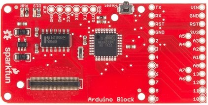

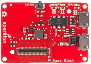

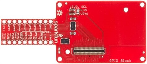

Since my purchase some time ago, Sparkfun have come to the party and produced a range of stackable boards.
In some cases they are close to the same outside dimensions, and others have features that will be useful.
You can see their range here.
https://www.sparkfun.com/categories/272
I had these on order about the time I found the external DC input was dead, and they turned up yesterday.
(You have to love how efficient USPS is)
The Arduino Block is an obvious choice to provide interfacing, while the Base Block allows console access, and the GPIO Block gives level conversion.
What these photos don't show is that they stack under the Intel Edison and are extremely thin.
I had plans to make a pcb with power and level conversion but after seeing the 70 pin Hirose connector pin spacing, I'm having other thoughts.

    DAB over 9 years ago +1
    Hi Mark, There looks to be some interesting parts in the kit. I always worry about heat dissipation with stackable boards, but I have not noticed the Edison getting warm while in use, so you should be…
    mcb1 over 9 years ago in reply to DAB
    I found it gets quite warm.
    However in this instance the Intel Edison is at the top so hopefully it dissipates.
    Hi Mark,
    I always worry about heat dissipation with stackable boards, but I have not noticed the Edison getting warm while in use, so you should be ok.
    I agree with you about not trying to do your own PCB.  That connector is just too small.
