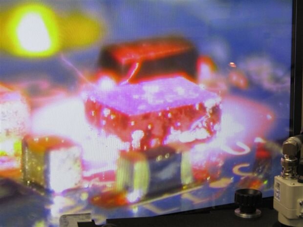

This time we chose a profile to suit the solder and let it rip.
The image taken from the progress camera screen shows the IR energy heating the component.
The bright parts are excess solder paste that migrated around during the various attempts to place the IC correctly (dropping didn't work) with the correct orientation.
For those interested, we worked out that the extra holder was most likely to prevent the board from flexing during the placing process, but the process camera was very useful to see when we had 'touchdown'.
The reflow process is controlled by the profile, and unlike the manual hot air 'hit and miss' approach this is absolutely repeatable.
This gives you an idea of the profile, which is just starting out. (20 secs in)

A check under the microscope again showed some pins may not have been soldered.
It was likely that the solder under the thermal pad was too much and had held the IC a little too high off the board.
For larger IC's with the thermal pad underneath, they often have a via or a trace which helps ensure there is no excess.
An application of liquid flux and another cooking should sort it out, but the reality was it cleaned it up, but didn't move it.
In the end some careful heating with a very fine tip soldering iron made it look perfect.

    Alternatively I could be barking up the wrong tree and there is something else going on with this that caused the issues you are seeing which is also quite likely.
    Best Regards,
    Rachael
    shabaz over 9 years ago in reply to rachaelp
    I think the vias are fully plugged on that Edison board. I briefly looked at it a while back, it appeared to be an extremely high quality board, with no expense spared : ) Also the legends and general style appeared to indicate that they may be using the same CAD system and/or people as (at least some of) their Intel server boards.
    Mark's top photo shows some resistor or cap at the top-right of the photo, going to a via, which looks plugged too.
  • rachaelp
    rachaelp over 9 years ago in reply to shabaz
    Yes you are probably right, Intel should know what they are doing when they design boards and you are right, looking at some of the other vias we can see on the board they are plugged. I guess if we can see what temp it's running at when using 12V once Mark gets it fixed again that will confirm one way or another if it's a thermal issue that's killing it or something else.
  • jc2048
    jc2048 over 9 years ago in reply to rachaelp
    The chip has a thermal shutdown, so shouldn't die, at least not on a one-time over-temperature. The shut down can be a bit mysterious if you aren't expecting it - it has about 20C of hysteresis, so you have to wait a fair while for it to come back to life. It is a strange one to fault-find because it doesn't relate to anything electrical going on, you just have a device turning on and off at stupidly long (in electronic terms) intervals. [Confession time: I've only seen it once and that was the time I left the thermal vias out.]
    mcb1 over 9 years ago in reply to rachaelp
    It seems the board information is here
    http://download.intel.com/support/galileo/sb/Edison_arduino_5_0826.brd.zip
    They comment that it is the Allegro Board Design file
    Allegro* Design File for the IntelRegistered Edison Board for Arduino*
    It seems there are free viewers.
    mark
