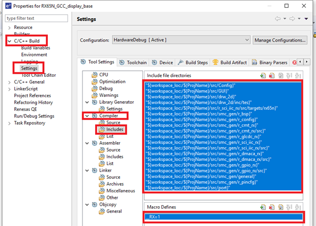

There's a significant number of includes to add, and a macro definition:

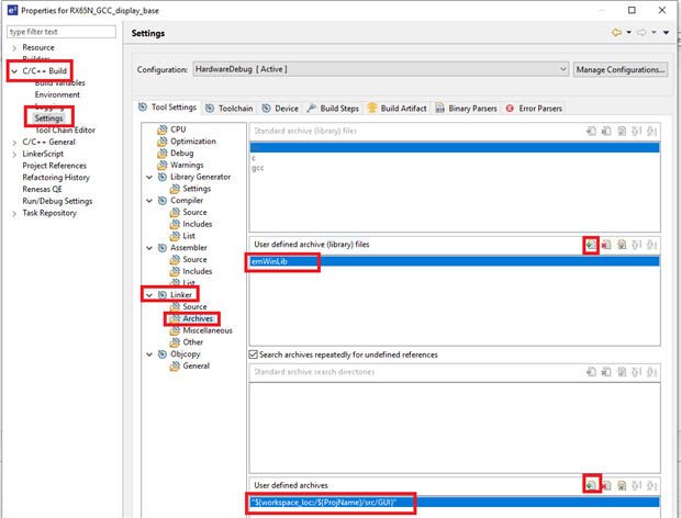

In the emWin version licensed for this evaluation kit, most of the logic comes as a precompiled library. We have to link it in (there's a dedicated one for GCC).
First add the library path to the user defined archives directory. The lib is located in the ./src/GUI folder you copied over from emWin's example earlier.
Then add the emWinLib to the user defined libraries.
Try to build the project. It should be successful.

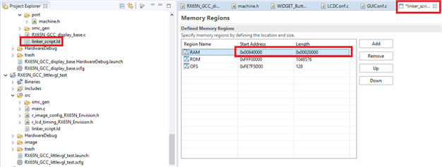

Memory Mangement
The RX libraries define two buffers on fixed memory addresses.
Renesas has configured the CC-RX linker settings to not use these sections for code. We'll have to do the same for the GCC linker file.
note: In the prevous post I've documented how to use a structured approach to guard the buffers. In this post I'm not using it.
I'm using Renesas approach with fixed addresses and telling the loader to load all code and data after the 2nd buffer in expanded RAM.
In a next post I'll convert this to structured memory sections, but that requires changing some example code. I tried to avoid that in this first post.

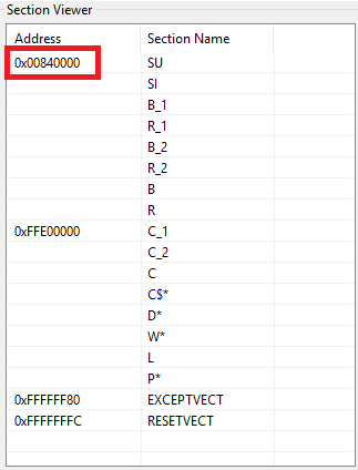

The CC-RX example starts loading user code at address 0x00840000.
The two buffers are in 2 fixed areas of the RAM, at the start of the standard and expansion RAM blocks.
This construct is in ./config/LCDConfig.c.
*       Static data
static const U32 _aBufferPTR[] = {
  0x00000100,  // Begin of On-Chip RAM
  0x00800000   // Begin of Expansion RAM
Renesas has given 0x00840000 as the safe address to start (giving all standard RAM and 0x40000 bytes of expansion RAM to the graphic library as buffer).
The total expansion size is 0x60000. That leaves 0x20000 for code and data.
The easiest way to explain that to GCC's linker is as such in the linker file:

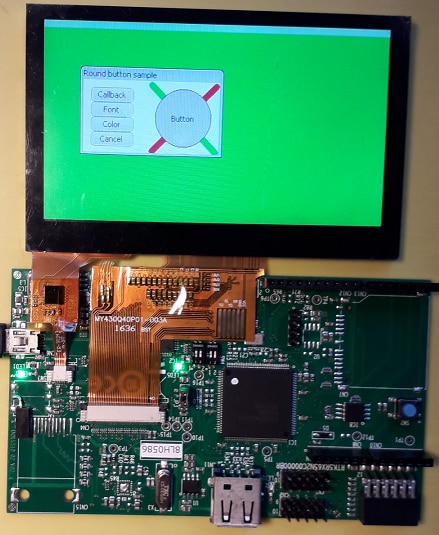

Now build the project again, then execute it.
You will get a dialog window with 5 controls. You can freely drag the dialog across the screen.
The button on the right side is the custom widget. Standard, it behaves as a normal button.
Press the callback button on the left and it turns into a custom round one. You can change its attributes by pressing the other buttons on the left screen part.
Check how it behaves by clicking on it...
