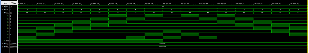

Test bench and simulation
The test bench uses a for loop to iterate through all possibilities of the signal indicating the amount to rotate.
`timescale 1ns / 10ps
module barrel_shifter_built_case_testbench;
    logic [7:0] data;
    logic [2:0] amt;
    logic [7:0] out;
    barrel_shifter_built_case uut(.*);
    initial begin
        for (byte i = 0; i < 8; ++i)
            begin
                data = 8'b1111_0000; amt = 3'(i); #10;
            end
        $stop;
    end
endmodule
In the image of the scope you can see how the values are shifted to the right amt bits, towards the LSB bits and how the MSBs are filled with the overflowing bits, rotating the information from left to right.

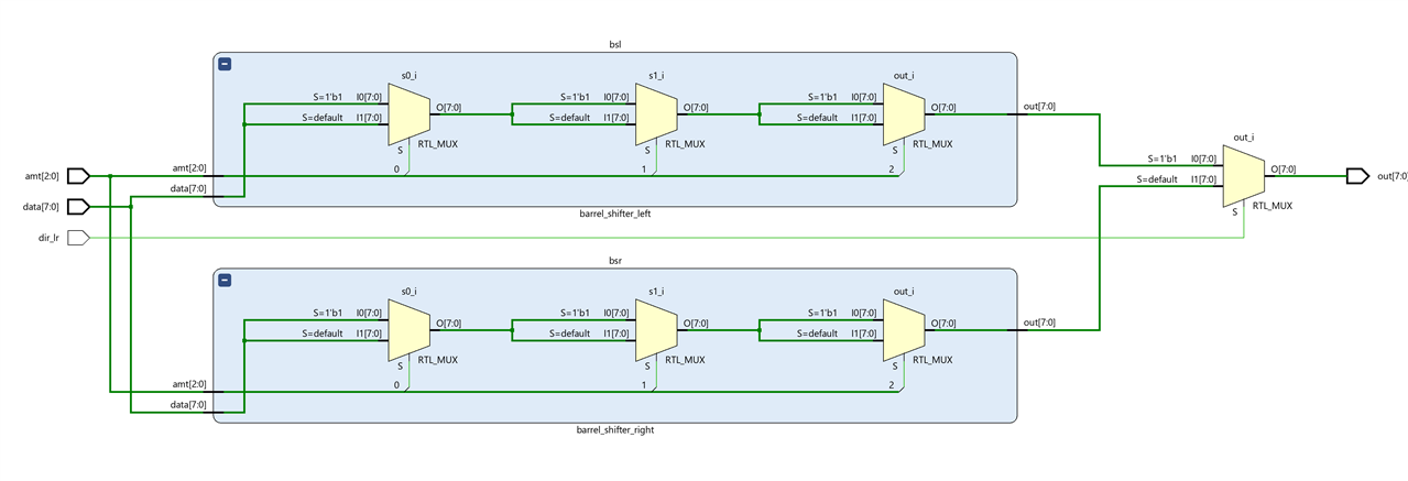

Multi-function barrel shifter. Rotating right or left.
We are going to complicate our barrel shifter a bit by adding a new signal that allows us to control the direction of the shift of the bits. With this signal we can tell the barrel shifter circuit if we want the output with the bits shifted an amount of bits to the right or to the left.
This 8-bit shifting circuit that can perform a rotating-right a rotating-left operation. An additional 1-bit control signal, dir_lr, specifies the desired direction.
First we will design the circuit using one rotate-right circuit, one rotate-left circuit and 2-to1 multiplexer to select the desired result.
A possible SystemVerilog implementation
const logic ROTATE_LEFT = 1'b1;
const logic ROTATE_RIGHT = 1'b0;
module barrel_shifter_multifunction(
    input logic [7:0] data,
    input logic [2:0] amt,
    input logic dir_lr, // 1 rotate left, 0 rotate right
    output logic [7:0] out
    logic [7:0] outl;
    logic [7:0] outr;
    barrel_shifter_right bsr(.*, .out(outr));
    barrel_shifter_left bsl(.*, .out(outl));
    assign out = dir_lr == ROTATE_LEFT ? outl:outr;
endmodule

The code includes two 8-bit rotating shifters, one to the right and one to the left. Using a 1 to 2 multiplexer, the output of one of the shifters is selected.
The two expanded shifters, each shifter has 3, 1-to-2 multiplexers for each of the stages required for the 3-bit shift amount signal.

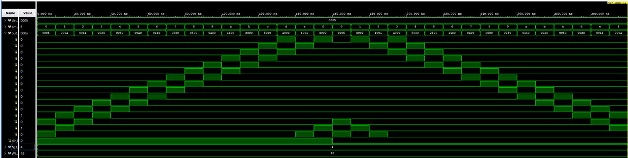

Test-bench and simulation
The test-bench code loops through all possible shift amount possibilities for the two possible shift cases, left and right.
module barrel_shifter_multifunction_testbench;
    logic [7:0] data;
    logic [2:0] amt;
    logic [7:0] out;
    logic dir_lr;
    barrel_shifter_multifunction uut(.*);
    initial begin
        assign dir_lr = ROTATE_LEFT;
            begin
            end
        assign dir_lr = ROTATE_RIGHT;
            begin
            end
        $stop;
    end

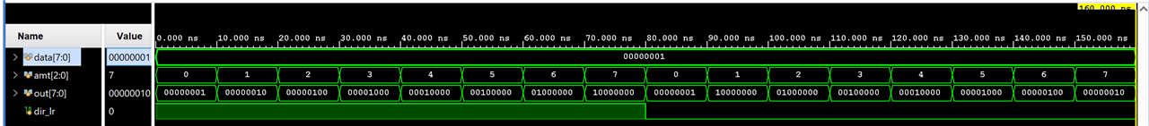

Simulation
The scope view first shows us all the left shift cases and then all the right shift cases for the original string 8'b1111_0000

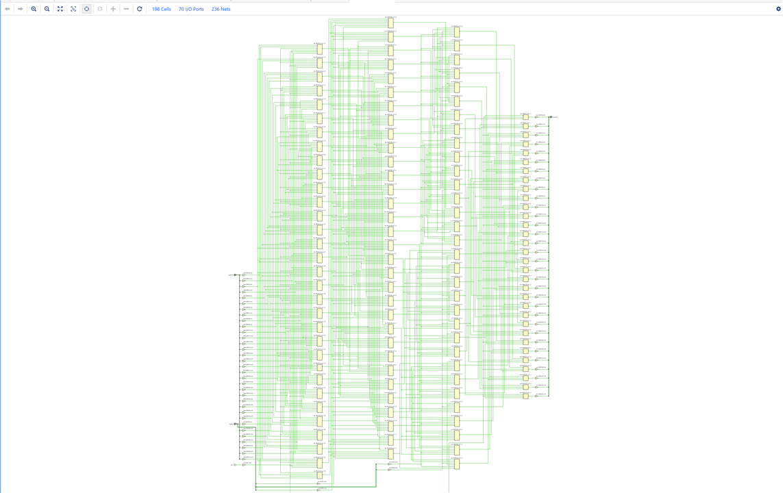

The synthetized design uses 44 cells

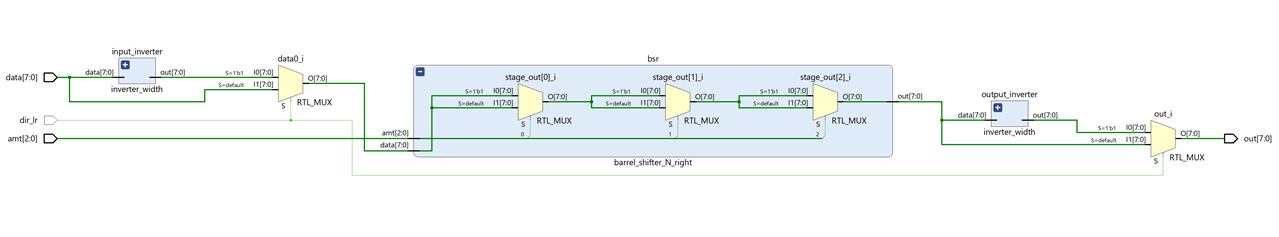

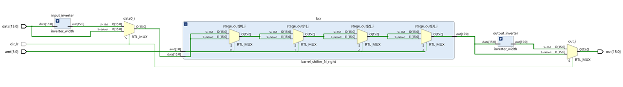

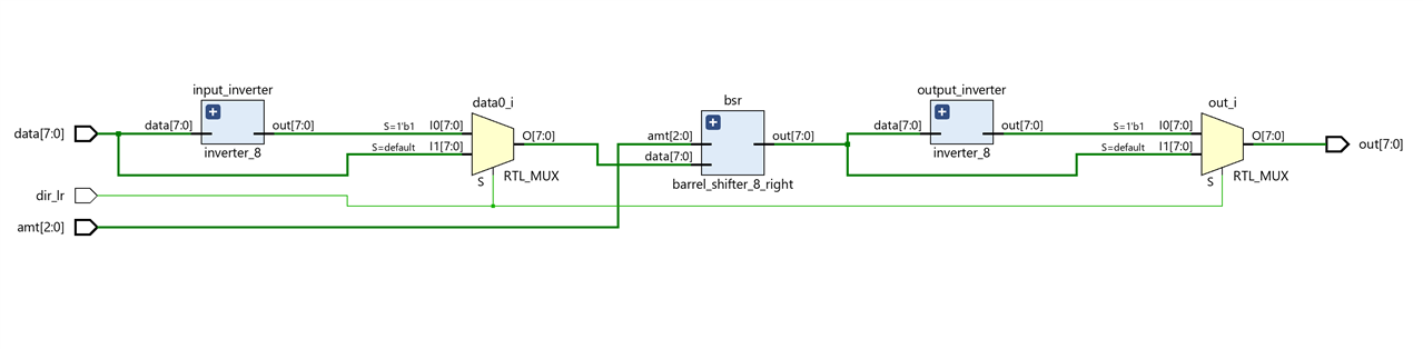

Multi-function 8-bit barrel shifter with pre and post reversing circuits
This circuit can also be implemented by one rotate shifter with pre- and post reversing circuits, so the basic multiplexing function can perform both operations. The reversing circuit either passes the original input or reverses the input bitwise.
// Barrel Shifter using a Rotate-right-shifter with pre- and post-reversing circuits
module barrel_shifter_multi_rev(
    logic [7:0] out_right; // output result
    logic [7:0] reversed_outr; // reversed output rotation for right rotation
    logic [7:0] reversed_data; // reversed input data for left rotation
    // if rotate left use rotated input data
    barrel_shifter_8_right bsr(.data((dir_lr == ROTATE_LEFT) ? reversed_data:data), .amt(amt) , .out(out_right));
    // reverse input circuit
    inverter_8 input_inverter(.data(data), .out(reversed_data));
    //  reverse output circuit
    inverter_8 output_inverter(.data(out_right), .out(reversed_outr));
     // if rotate right use rotated output
    assign  out = (dir_lr == ROTATE_LEFT) ? reversed_outr:out_right;
endmodule
// reverse 8-bit data
module inverter_8(
// reverse a vector using right-to-left streaming with the default block size of 1 bit
  assign out = {<<{data}};
endmodule
// rotates amt bits of data to the right
module barrel_shifter_8_right(
    logic [7:0] s0;
    logic [7:0] s1;
    //stage 0, shift 0 or 1 bit
    assign s0 =  amt[0]? {data[0], data[7:1]} :data ;
    //stage 1, shift 0 or 2 bits
    assign s1 =  amt[1]? {s0[1:0], s0[7:2]} :s0 ;
    //stage 1, shift 0 or 4 bits
    assign out = amt[2]?{s1[3:0], s1[7:4]} :s1;
endmodule
To reverse the date we use right-to-left streaming with the default block size of 1 bit: assign out = {<<{data}};

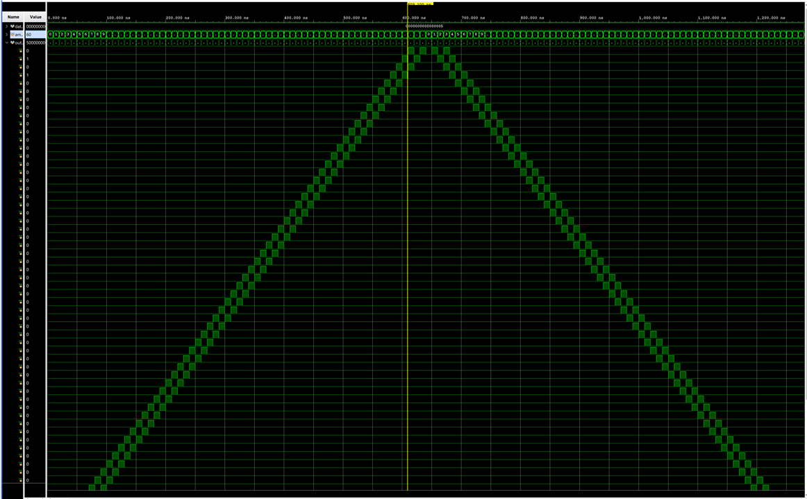

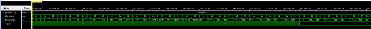

Test bench
We use the same test-bench as in the previous case.
module barrel_shifter_multi_rev_testbench;
    logic [7:0] data;
    logic [2:0] amt;
    logic [7:0] out;
    logic dir_lr;
    barrel_shifter_multi_rev uut(.*);
    initial begin
            begin
                data = 8'b0000_0001; amt = 3'(i); #10;
            end
            begin
            end
        $stop;
    end
endmodule
Simulation
We do the simulation in this case with the string 8'b0000_0001

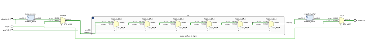

In the schematic of the elaborated design we can observe the two reversing circuits that invert the position of the bits both at the input and at the output. The two multiplexers that select the non-inverted or inverted output input based on the shift direction and the right shift circuit. Only a single shifter circuit is needed in this case.

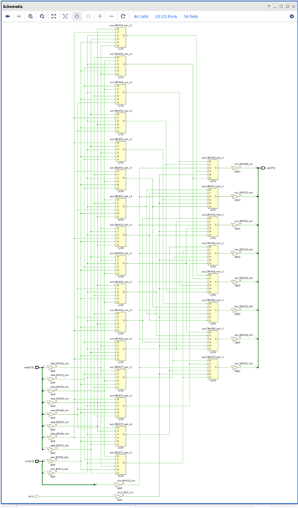

The synthetized design uses 44 cells.

We do the simulation in this case with the string 32'b0000_0000_0000_0000_0000_0000_0000_0001

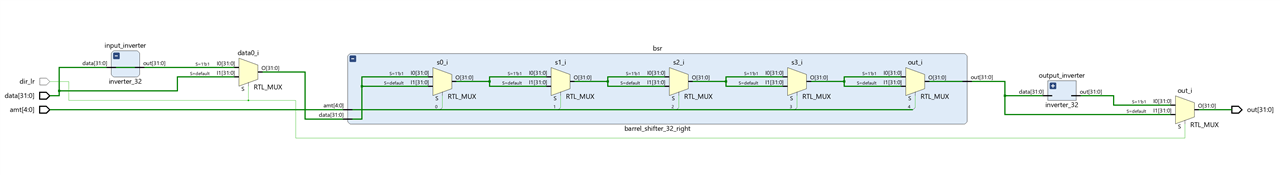

The scheme of the elaborated design is similar to the one elaborated for 8-bits we see that the sizes of the data buses change, they have been enlarged to the new sizes.
Expanding the barrel shifter block we see that the number of multiplexers has increased due to the new shifting stages required.
The synthesized design is getting more complicated.

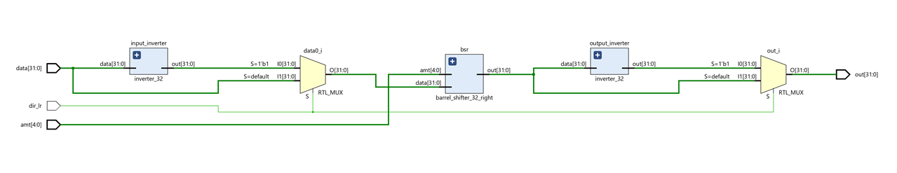

The code includes the previous right barrel shifter and adds a new one in the opposite direction to the left. Depending on the address signal dir_lr one or the other is selected.image
Expanding the two barrel shifters we can see how this solution needs more multiplexers than the previous one.

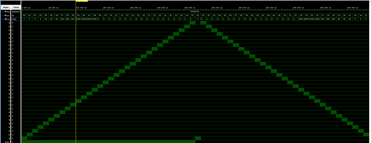

Simulation
In the simulation we can see graphically how the offset affects the single bit at high.
The synthesized design is similar to the previous one with 198 cells

Since now the number of stages to shift the data is variable, we can use a generate block to generate the different necessary stages in a loop.
 generate
genvar stage ;
assign stage_out[0] = amt[0] ? { data[0], data[WIDTH-1:1]} : data;
for (stage = 1; stage < N ; ++stage)
begin
assign stage_out[stage] = amt[stage] ?
{stage_out[stage-1][stage**2:0], stage_out[stage-1][WIDTH-1:2**stage]}
: stage_out[stage -1];
end
assign out = stage_out[N-1];
endgenerate
Simulation with N = 3, Word width = 8,
N = 4, Word width = 16 bits. 4 stages
 N = 6 Word width = 64 bits

Elaborated design
