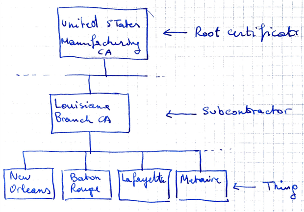

In this post I use three levels, where the top level is the intellectual owner of all things. The lowest level is a device. All intermediates are partners in-house or outsourced partners we may deal with.
  • a conglomerate called United States Manufacturing: they are designers of a Thing that should be installed in every city in the United States.
  • a number of subcontractor / suppliers. One per state. One is called Louisiana Branch: they manufacture and program the things on behalf of the conglomerate.
  • a set of IIOT things (fondly named after the cities they will be installed in). Made and programmed by the subcontractor. Each thing needs its certificate to uniquely define it and enable it to connect.
I use 3 layers. But between the Root and the Things, there can be an arbitrary number of players.
All principles used in this article hold. No one needs to share secrets. All should have a trusting relationship with the one above.

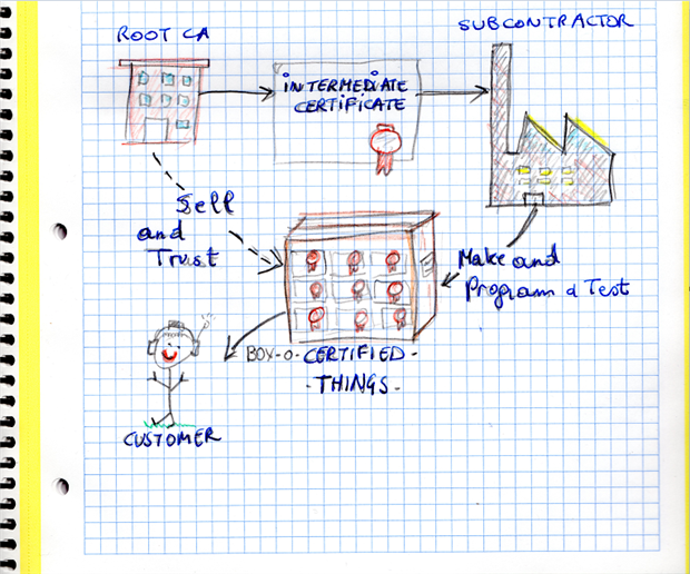

You could ask the subcontractor to generate a certificate on your behalf, at the time they are programming a thing.
But you'd have to share your private key and the related password.
Don't do that.
Security
You should keep your private key and the signing password secret. It's a base principle of working with certificates.
Should you share it with your subcontractors, and their staff at the production line that do the programming? No.
Intermediate Certificates Help
Queue intermediate CA certificates.
They allow that you grant the subcontractor the power to generate and sign Thing certificates on your behalf.
If you allow them, the subcontractors can even generate a dedicated intermediate certificate for each resource (or production batch) that generates and signs certificates at the production line.
All without sharing private keys and passwords.
With full traceability from Root to Thing.
And you, as the conglomerate that owns the chain,  can still use your public key only to "validate the validity".
With the power to blacklist devices, particular subcontractors, particular production batches...
