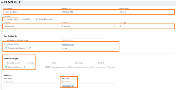

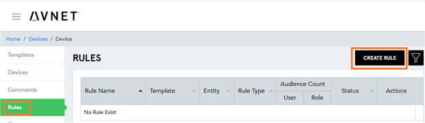

Create the rule
I'll create a simple rule. It's based on a fixed condition of a single parameter:
if temp < 0, send email.
I've set it up to send an email to a single user, myself:
This is the result after saving:

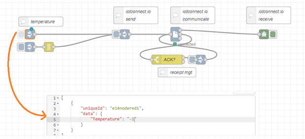

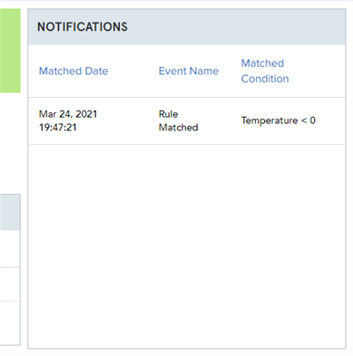

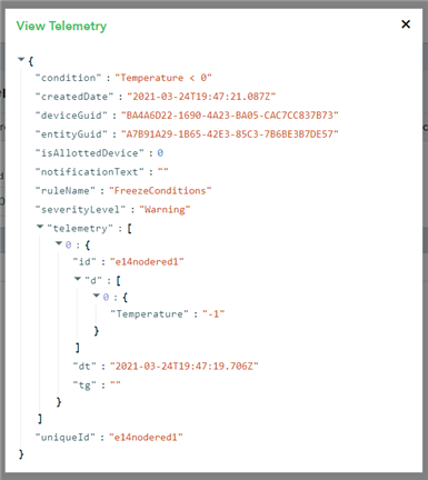

I'm using the "inject a temperature" part of my Node-RED flow to simulate that I measure "-1 °C".

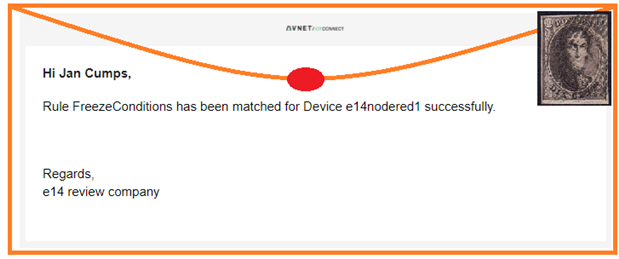

The mail arrives:
You can see the content in the header of this post.

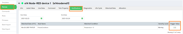

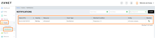

Here's how you can monitor the rule in the console, for all your notifications:
And here how you can see the rules that were executed for a particular device:
