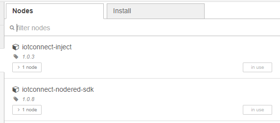

Install the Node-RED SDK
The iotconnect module for Node-RED has two components, a connection and a command inserter.
To install, navigate to the Node-RED install directory.
On a Linux machine, that's often the .node-red subdir of your home.
Then register to the iotconnect repo
$ npm adduser --registry https://repo.iotconnect.io/
$ username: <retrieve from https://help.iotconnect.io/documentation/sdk-reference/device-sdks-flavors/node-red/  >
$ password: <retrieve from https://help.iotconnect.io/documentation/sdk-reference/device-sdks-flavors/node-red/  >
Enter an email address - I used the one from my iotnet.io subscription. AVNET informed me that if you have issues with the download account, you can reach out to https://knowledgebase.iotconnect.io/contact/
Then install the nodes:
$ npm install iotconnect-nodered-sdk --registry https://repo.iotconnect.io/
The nodes are added to your installation.

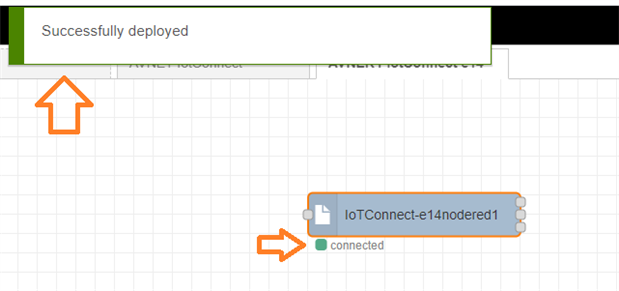

Connect for the first time
Start node-red and surf to the designer page.

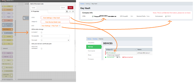

Create a new flow, and place a connection:
You have to enter 3 attributes:
  • CPID. This is the customer number on the Key Vault page. Do not share this
  • Unique ID. Your device's unique ID as available on the Device page
  • ENV. Selection box. Select the Environment that's shown in the key vault.
Deploy the flow. If you did everything correctly, the node shows it's connected.
The dot coloured green:
Celebrate.

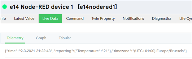

First Data exchange

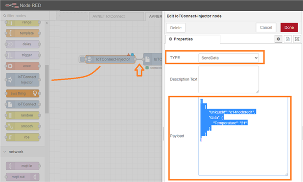

Let's send the first telemetry data to the iotconnect.io cloud.
Add an IotConnect Injecter node and fill in the JASON package:
        "uniqueId": "e14nodered1",
        "data": {
            "Temperature": "21"
The uniqueID is the same one you used when defining the connection.
The attribute has to be one that's registered in the template. We added Temperature.

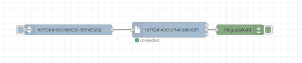

I added a debug block at the end as part of the test, but that's not needed.
It shows the payload , if it's sent correctly to the cloud.
Press the Inject node's button. The message is sent to iotconnect.io:
Celebrate again.

    If you use the same Unique ID as me in your exercise, only change the CPID in the Connect node.
    Jan Cumps over 5 years ago
    What my post does not show, is that this works well together with the common Node-RED components:
    The payload does not have to come from  the bespoke IotConnect injector. You can keep it empty and feed it with a payload:
    The payload in my little demo here comes as a JSON message from a generic component. In this case a plain Node-RED injector:
    but it could come from any Node-RED source.
