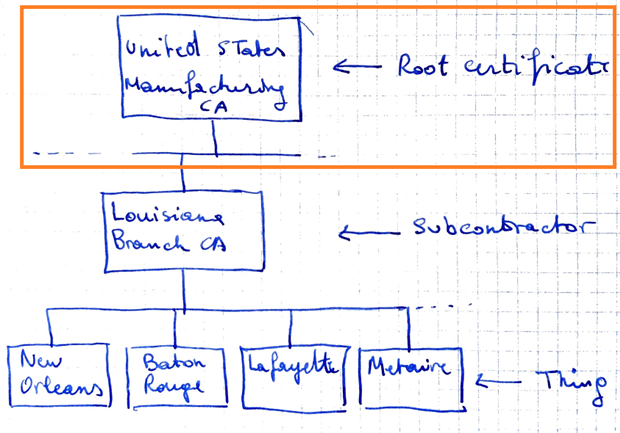

  • only the top in the hierarchy: Root CA "United States Manufacturing".
Readers of my previous article Connect to AVNET iotconnect.io with Node-RED - part 8b: safer connect with CA certificates will find overlap.
But that's partly. The series 9 of this saga defines policies and rules that deal with delegating while keeping control.

In this series, we are dealing with a number of partners that already have a chain of trust.
That is common in a supply chain where you've negotiated contracts. Or when dealing with subsidiaries, depatments, employees.
If you are in a scenario where the relationship is legal, or business financial (orders, invoices, ...), you may want to (but not always have to) consider to purchase the genesis certificate from a universally trusted commercial provider.

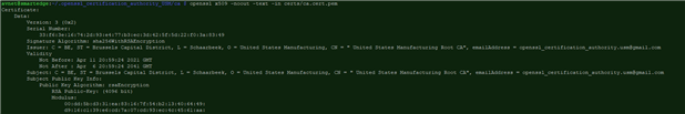

When prompted for the Common Name: United States Manufacturing Root CA
Inspect the root certificate
openssl x509 -noout -text -in certs/ca.cert.pem

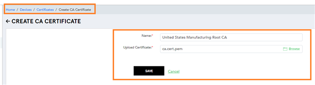

Log on to the IoTConnect portal, select Devices -> Certificates -> Create.
Name the certificate, then select the public certificate you just created in the previous step.

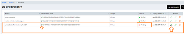

The certificate is uploaded now. But it's not trusted yet, because IoTConnect doesn't know yet if I control it.
Proof to IoTConnect Cloud that I Own the Root Certificate

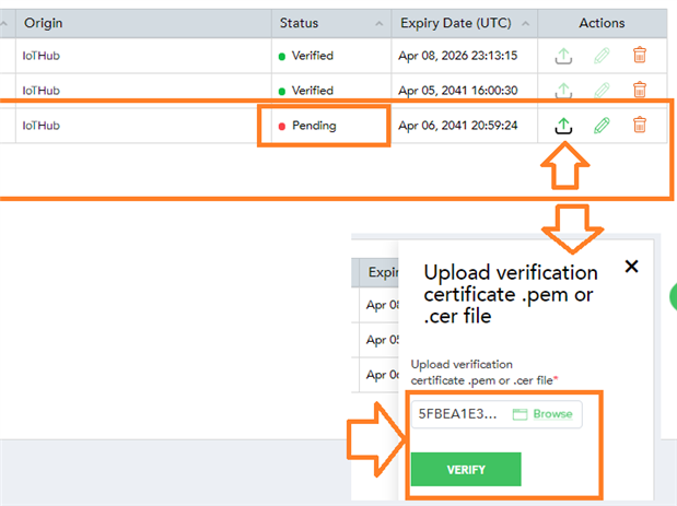

That's the next phase. Two steps:
  • The portal gave a challenge code when I uploaded the certificate. You can spot it in the screenprint: 5FBEA1E31A4A99B2C7AFE1C4FBFB288948B655B8B028F807.
    I challenge is that I have to use that root certificate, its private key and password to generate a temporary validation certificate.
    It's a one-off certificate that has to have the challenge code as its common name.
    You need to have the key and password to complete that exercise.

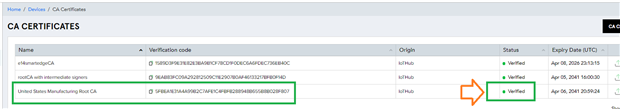

    When you are able to generate such a temporary validation certificate, IoTConnect knows you own the keys, and that the root certificate is indeed controlled by you.
  • You then need to upload that certificate to the portal. If validation passes, your root certificate becomes a valid and active validation mechanism on IoTConnect Cloud.

upload the validation certificate to IoTConnect Cloud to activate the Root Certificate
Now use the public certificate you just created to validate the root certificate on IoTConnect Cloud:
When successful, you get this message at the bottom of the screen:
... and the certificate shows as verified. It is now valid.
