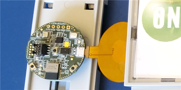

If you wonder what the ON Semiconductor RSL10 kit is, check out these 2 recent road tests: RSL10 Sensor Development Kit and ON Semi RSL10-SENSE-DB-GEVK Sensor Board.

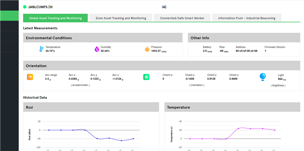

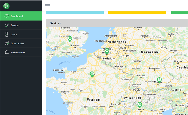

Here you can see it in action in an end-to-end sensor to cloud application, with the SmartEdge gateway collecting and uploading the sensor data.
For a detailed review of the cloud dashboard, check part 5: A Cloud User Experience Example.
