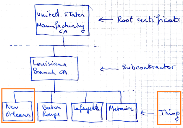

You, as subcontractor Louisiana Branch, will generate and sign certificates for Things, on behalf of the conglomerate United States Manufacturing.
No private keys will be shared. The subcontractor can generate the certificates, one for each Thing.
We as Root CA will only allow devices on our cloud that have a valid certificate chain and are provisioned.

Create a Key Pair for the Thing
I've consistently used Certificate and Private Key in the series. But we're at the end, time to loosen up.
A certificate is the same as a public key. A certificate + private key is a key pair.
Key pairs are used to authenticate. Let's make one for the Thing that will be installed in New Orleans, LA.
In this post you will see that I have a code in front of the thing's unique name neworleans.
That is IoTConnect.io specific. The unique name is formed by the CPID (a code you get when enrolling, I obfuscated mine), and the unique name you define for your device. Separated by a '-'.
You are now pretending you are the subcontractor.

The subcontractor has everything needed now for a successful connection:
  • device public certificate chain: b***2-neworleans.cert.pem
  • device private key: b***2-neworleans.key.pem
  • Root CA certificate ca.cert.pem
