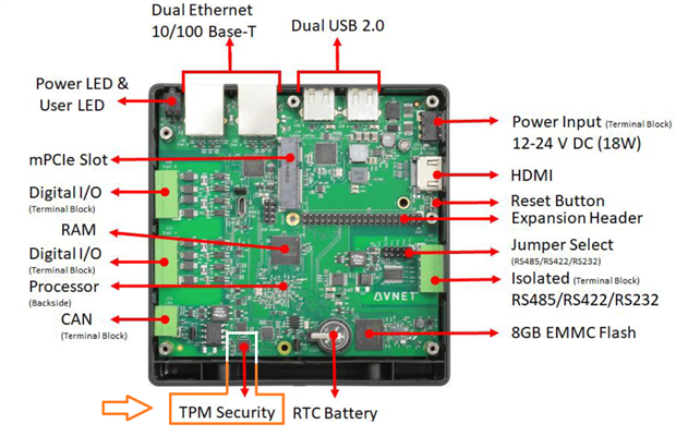

You need hardware that supports TPM. I'm using the Avnet SmartEdge IIOTGateWay. It has an Infineon SLB9670SLB9670 (datasheet) IC on the pcb. This TPM module has a unique ID (+Endorsement Key (EK) and EK certificate). And it's supported by Linux kernel. See here for a breakout post: Infineon SLx9670 Trusted Platform Module (TPM) for IoT Security.
In essence, what happens in this post, for hardware and software, is identical to this post on GitHub, but on the SmartEdge, this is part of the out-of-box setup. Infineon has a module for Raspberry Pi that gives the same experience.

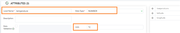

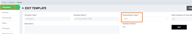

Create a template that supports TPM authentication
I've created a number of templates in this series. Everything is the same, except that this time I select TPM as Authentication Type.
Like the other examples, I create the attribute.
I've also created a longitude and latitude attribute. That's for later, when I'm going to show the portal's capability to show a device on a map.

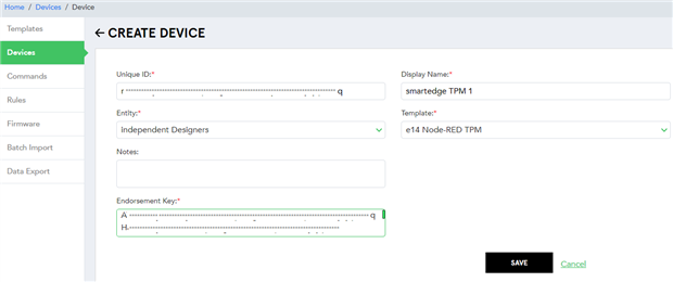

Provision a device

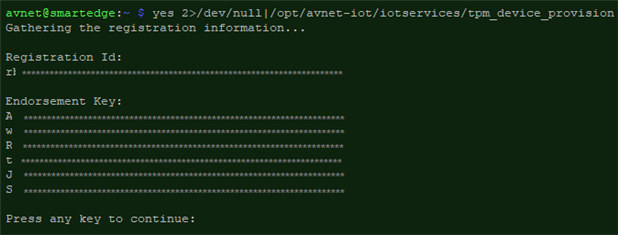

The keys to register a TPM on IoTConnect, are ihe unique ID of the hardware TPM and the Endorsement key of that module.
IoTConnect cloud runs on Azure, and the Azure utility tpm_device_provision is used to get that data.
Source code is available on GitHub. On the SmartEdge, it's installed out of box.
The utility uses the Linux TPM driver to get the info, and can be executed from the command line:
yes 2>/dev/null|/opt/avnet-iot/iotservices/tpm_device_provision
The output has all info I need. Not in a friendly way to collect from a command line, but the Avnet Python samples show how you can retrieve the relevant data.
id_ek = cmdline("yes 2>/dev/null|/opt/avnet-iot/iotservices/tpm_device_provision")
            lines = id_ek.splitlines()
            uniqueId = mystr(lines[3], 'utf-8')
            EndorsementKey = mystr(lines[6], 'utf-8')
The Avnet example then uses the REST api to provision the device. Here's the same process via the portal:

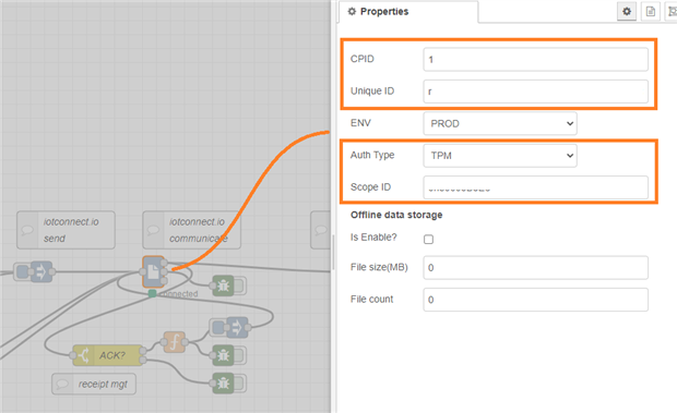

On the device's Node-RED flow, you have to set the Registration Id from the previous step as unique id.
Like all previous posts, the CPID is retrieved from the IoTConnect portal.
The Scope ID is a value you also get from Avnet when registering. For trial subscriptions, you can usually find it back in the IoTConnectSDK.conf.default they provide.
That is it. The rest of the flow is exactly the same as in all previous posts.

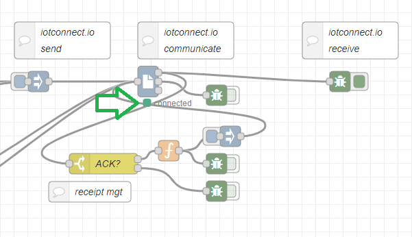

When you enable the flow, you should see the green embelishment and Connected label under the IoTConnect node.
As usual with security, the end result doesn't look spectacular.
The real power is behind the scenes: hardware based authentication.
