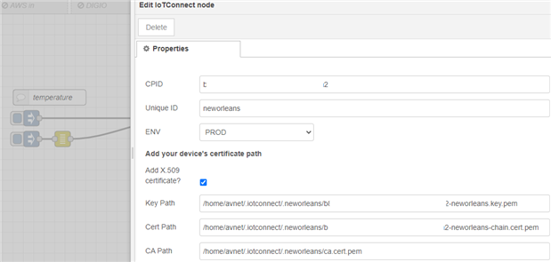

Upload the certificate artifacts. This is highly dependent on the device you have.
Some provide a dedicated memory area that can only be read by firmware.
Some have a key vault.
On Linux, place it in a folder that's only readable by the user that runs the firmware (here: the Node-RED service user).
In this scenario, we need the tree artifacts generated in the previous post.

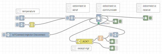

Configure and load the firmware. In our case a json file with a Node-RED flow.
The automated script would automatically configure customer ID (cpId), unique ID, and if we use unique names for certificates, also those.
Then import in Node-RED.

Refer to this post for the correct ACK handling.

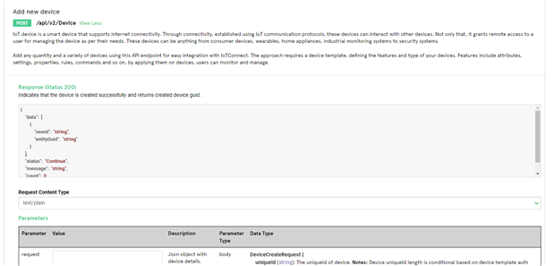

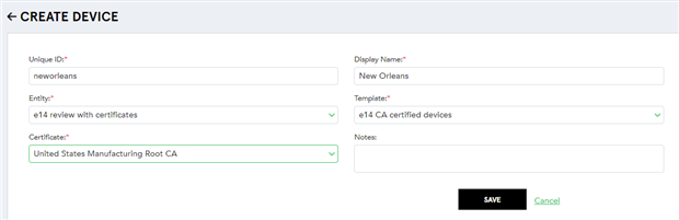

In parallel, another service at the subcontractor can use the IoTCloud REST API to provision the device on the cloud.
I may write a post on how to do that.
For the moment, I'm doing this manually in the portal:
It's also fast, but automation is better.

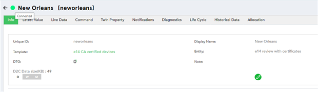

The subcontractor engages in testing. Manually or automatic.
Both Node-RED log and cloud portal report success.
In our case, this can also be scripted: start Node-RED and parse the output.
Or the IoTConnect REST API can be used to retrieve the status. This could again be done at the production line.
Successfully programmed devices can be packaged, failing ones binned in a rework container.
