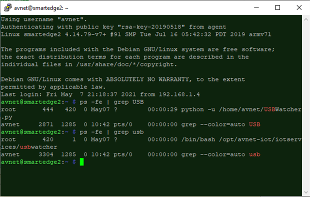

There's a shell script in the IoTConnect folder /opt/avnet-iot/iotservices, named usbwatcher.
#!/bin/bash
if [[ $EUID -ne 0 ]]; then
  echo "This script must be run as root"
  exit 1
fi
python -u /home/avnet/USBWatcher.py
And a service wrapper in /etc/systemd/system, named usbwatcher.service.
[Unit]
Description=UsbWatcher OnSemiConfiguration
StartLimitIntervalSec=0
[Service]
ExecStart=/bin/bash /opt/avnet-iot/iotservices/usbwatcher
Restart=always
RestartSec=10
[Install]
WantedBy=default.target
This takes care that you can start and stop the service, enable it at startup, ...
