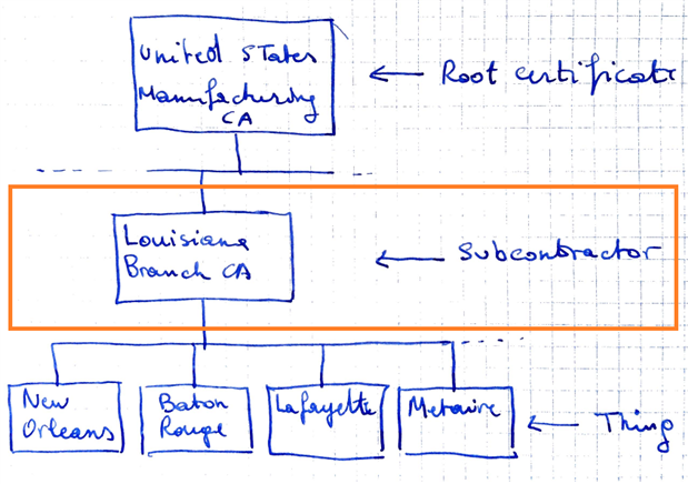

You will generate an Intermediate Certificate for your supplier. They can then use that to sign Things on your behalf.
No private keys will be shared. The subcontractor can generate their own private key and generate a certificate request based on that.
We as Root CA can then generate a valid certificate based on the request, without the need to get the subcontractor's key.

You, the Root CA, will now generate an intermediate certificate for the subcontractor.
It will be based on the request they generated in the step above.
The certificate is powerful. They can create new certificates on our behalf, based on it. Even other intermediate certificates.
That makes sense. They may want to also delegate the final certificate generation to an employee.
It makes sense for the subcontractor to generate an intermediate CA certificate to each employee. Only the employee knows their private key and password.
It keeps the cycle traceable and safe. No one needs to share the secrets.
