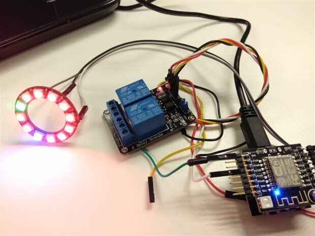

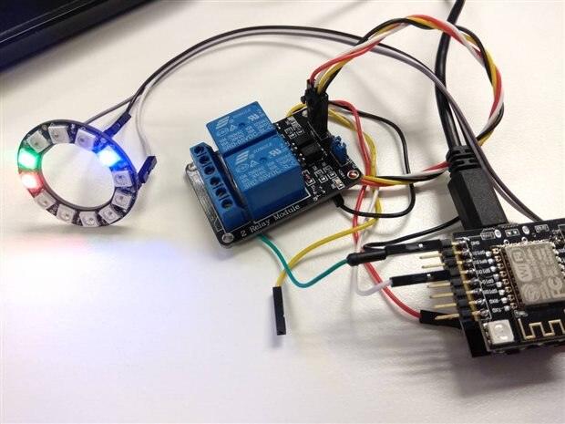

Proof
I offer the two images below to show it works.
The onboard LED is driven at the same time as the Relay, and you can see the display going red to signify an "Unknown Visitor".
After 60 seconds it returns to the normal time display
You can see the Red Relay LED is out and the blue Onboard LED is OFF.

(BTW you add TimeClient.h and TimeClient.cpp into the same directory as your sketch ... hence the quotes  #include "TimeClient.h" )
You could change the colour of the neopixels to indicate the Wifi is connected, but the broker isn't.
There are a few more tweaks to make this a bit more polished.
So there is my version of mqtt clients of the system.
I have always been keen to utilise this simple method of sending messages and status, but never really got around to trying it.
I can see more projects using these or the big brother ESP32
