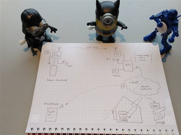

Concept
The idea is to detect the bluetooth transmitted from the vehicle and signal other Home Automation functions.
If the vehicle is known then it can open the garage door, and inform the home owner that xx is home.
Hardware
The detection point needs to be at the start of the driveway, and because there is no power source, this will need to be low power with solar charging.
The PSOC range seems a very good fit, but because of the timeline and my need to upskill, the inital design will be Arduino based and some form of RF transmitter/transceiver.
Adding a vehicle detection loop or beam is necessary to ensure those vehicles without bluetooth will also trigger the system.

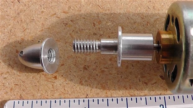

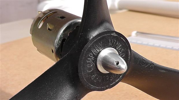

Long term the ability to power this is a combination of solar and wind, and I discovered a simple method that should work.
BT_Sentry : Bluetooth Options
This approach requires a bit more Engineering as the motor is not waterproof.
However the load is such that it shouldn't overheat, so restricting the airflow shouldn't shorten the life due to thermal issues, but will help with the environmental ones.

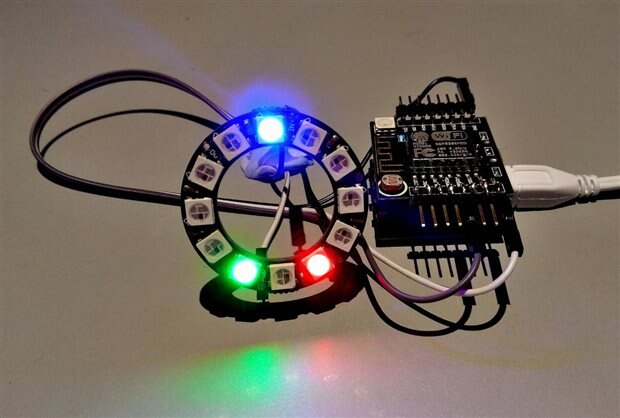

Some of the other Design Challenges and Project14 posts, used ESP8266 in other roles, and I was particularly interested in ntewinkel temperature sender.
Remote (Water) Temperature Monitoring
I could see that this would suit one of my other projects that have been waiting for a biblical flood (I've gone past waiting for a rainy day)
I found a great second use as a clock.
By combining this clock with the detection of a MQTT message, I could have something that was useful and served as an indicator.
The design and low cost allowed multiple units to be deployed.
It also was a possibility for the Door Controller and Outdoor Lights.
Adding a simple relay to one of the GPIO would allow the use of a MQTT message rather than the hassle of NodeRED and reconfiguring a Sonof device.
Unfortunately this took several days to sort out the Broker issues.

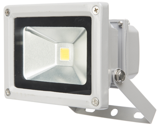

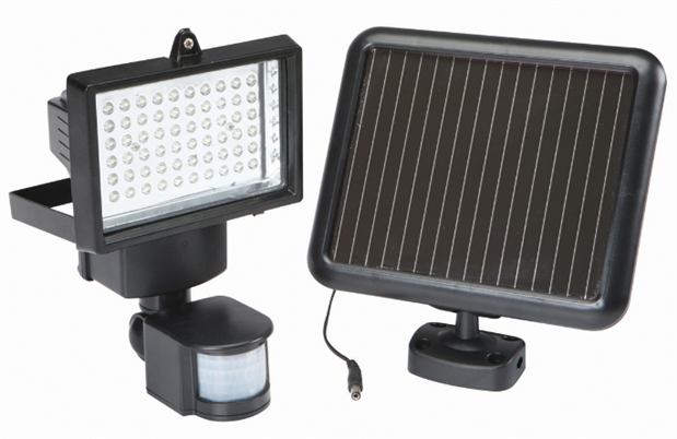

I planned to use an LED light similar to this
However it seems these have gone out of fashion and the latest offerings are the COB style LEDs.
which don't offer the same size or ability to modify to hide the camera.
So I might need to rethink the housing.image
