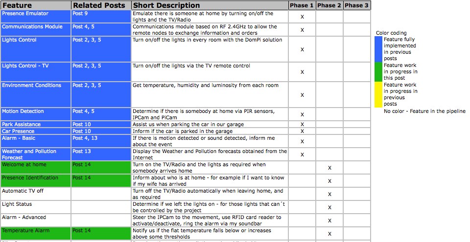

Project Status

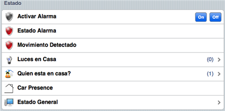

Presence Identification
This feature allows DomPi know, not only know if there is somebody at home, but also who is there. The best solution as of now to implement this, is to check whose mobile phone is at home. I know this has some drawbacks like, what if the phone is off or if we left it at home... To partially sort out this problem, DomPi also leverages the motion sensors to limit the impact of it and make it more reliable. Let´s have a look at all this.

Implementation in DomPi
Potentially, you can connect directly an item to the binding and just display in openHAB its status. Something like this:
Switch Papa_tlf_nh "Papa Network Binding"  <present> (gStatus, gPresencia_casa_nh) nh="192.168.1.140" }
This would display a switch showing if the mobile phone is in range or not. However, this would not be optimum. It seems that my mobile phone goes into sleep mode with the Wifi, probably to save up battery. I have not stress-tested but I guess while on sleep mode, it will not reply to pings. The solution I have implemented is to apply a double level of switches: one as above connected directly to the binding and yet another one controlled by an openHAB rule.
The rule will get the updated status from the first level switch. When it is in range, it will directly update the second level. However, when it is out of range, it maybe that the phone is on sleep mode. Therefore, it will wait 8 minutes. If within this time, DomPi has not seen the phone in range, it determines that the user/phone is out from home. The description of the second level switch is this:
Switch Papa_tlf "Papa" <present>    (gStatus, gPresencia_casa)

Welcome Home feature
With this, I intend to execute some actions when somebody has arrived home. At this stage, the action is to turn on the lights of the living room and the parents´ bedroom and in the next development it will also turn on the TV and switch it to the TV channel we usually watch. This can be very useful to us, as you can have some light at the end of the corridor without having to walk till there. Also the light in our room takes time to be fully lit, so it is good as well to turn it on some minutes in advance. I have written the code and split it in four openHAB rules.

Temperature Alarm
This feature notifies me per email if any temperature sensor at home is below 20ºC or above 27 ºC. Many thanks to jkutzsch who gave me the idea back in May, at the very beginning of the Challenge. Finally, I can implement it image I have implemented it in a single rule. If the alarm is triggered and the email sent to myself, then the rule launches a timer to wait for 1h before sending again any notification: I want to avoid spamming myself!

  • Show the internal average temperature and humidity in the main menu - before it was not implemented
  • Create a submenu which quickly shows the temperatures and humidity
