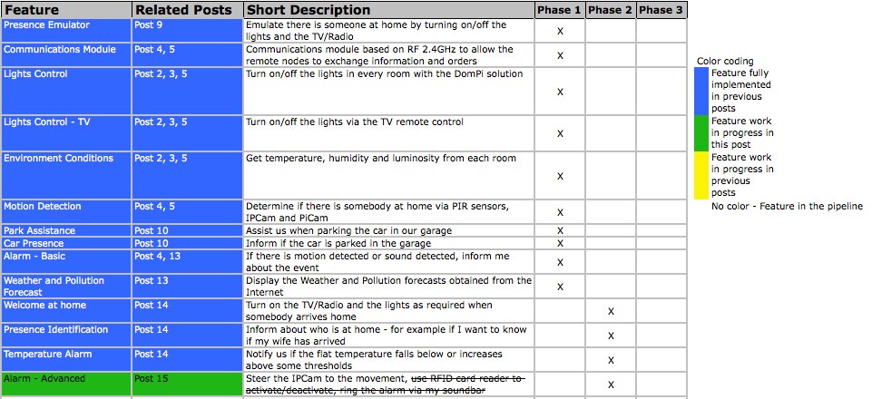

Project Status

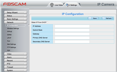

IPCam configuration
The first step to integrate the camera is to configure it using the web interface that Foscam includes. I will skip the basic configuration steps like the user and password, or IP configuration. Specially relevant for the DomPi project is to set up the preset points. A preset point is a position of the camera indicated on the X and Y axis so that it points to the desired place. In my case, I am setting up two preset positions: the preset to point at the living room and the preset to point at the corridor (and main entrance). I have placed the ipcam on top of my fridge where I can cover these two places with the same camera.
The web interface of IPCam is quite intuitive and adding a preset point is  easy, you just need to move the camera with the web buttons to the desired positions and save them. It is important to remember the names you save them with, as they will be the key part of the openHAB integration. There are some other interesting features to configure: sensitivity level (to trigger the alarm if motion is detected), trigger interval (how many seconds to wait before raising a new alarm), etc. I will touch these later on during the openHAB integration.
Before leaving the IPCam configuration, I have configured the email account where the Foscam camera has to send the pictures to. I have also configured my router to always assign the same IP to this camera since it will be required for the openHAB.

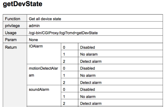

Foscam IPCamera CGI
My camera supports CGI string requests and the manufacturer has provided the CGI manual (here). This enables the control of the IPCam via http requests sent out from the openHAB. An example of these strings can be:
http://foscam_IPaddress:88/cgi-bin/CGIProxy.fcgi?cmd=setMotionDetectConfig&isEnable=1&linkage=7&snapInterval=2&sensitivi…
With this line, the IPCam will enable the Motion detection (see the &isEnable=1 part). If the motion is detected, it will inform the user via an email, it will also take a picture of the image and attache it to the email and finally it will also ring the ipcam´s buzzer (see the &linkage=7), etc, etc. To make it easier to follow, please find a snapshot of the above CGI manual that explains the setMotionDetectConfig parameter.
In the openHAB I am using the setMotionDetectConfig function, as well as two other more: getDevState (to check if there is motion detected) and the ptzGotoPresetPoint (to point the ipcam at the living room or the corridor).

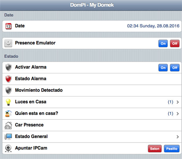

openHAB Integration
There is as such no openHAB binding, however, there is a nice webpage with key information to help you move faster on understanding how to integrate the camera (here). For DomPi, I just need the three functions below, so I have decided to implement it in a maybe not very sexy way, but... it works. I have created four items:
  • One switch: to enable or disable the Foscam IPcam alarm. When the switch is turned on, it sends to the camera the below cgi string that instructs the ipcam to start detecting motion. If turned off, it sends the "OFF:GET:..." string to the camera which stops the detection
  • One switch: to move the camera to the preset position of the living room or the corridor. If the switched is moved to the "On" position, DomPi points the camera at the living room. If it is moved to "off", the camera will point at the corridor
  • One string: that captures the motion alarm status: not enabled, no motion detected, detected motion
  • One string: to capture the sound alarm status: not enabled, no sound heard, heard sound

With this code, I am able to integrate the Foscam ipcam into DomPi. The camera includes many more features, which are not relevant to this project. One improvement if I need any of those features in the future, would be to leverage the general API from Foscam and the REST API from openHAB.

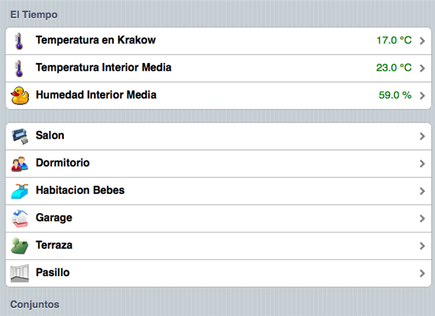

OpenHAB - Final View
These are some snapshots of the final view of the openHAB web interface for DomPi.

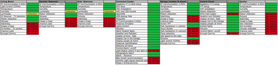

Nodes´ Dashboard
This is the final dashboard of the nodes, I am conscious that not all of the cells are green, but hope that you have enjoyed the journey since May till now with the DomPi project image
Attached you can find the latest version of the openHAB files and the final part for the project!! I hope you have enjoyed the DomPi posts as much as I have done it image Many thanks to all of you that have read the posts and have shared your comments with me on the things done well and also on what could be improved. I have learned a lot! And it´s been a great pleasure. A great pleasure that I shared also with my friends and family image
