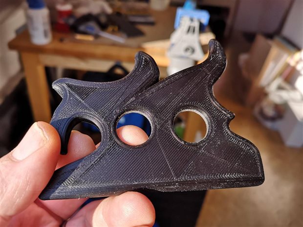

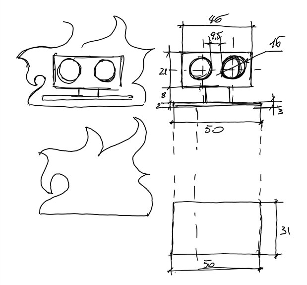

Dressing the Sensor in Style
Also for the sensor, I have designed the sensor support with Fusion360 following a similar style of the eye implant and the laser of SevenOfNine.
Above: the quoted sketch of the ultrasonic sensor support for the Magic Mirror.
Below: the 3D rendering of the finished support.
The sequence of images below shows the phases building the support and installing the sensor to its back.
{gallery} Magic Mirror Sensor Support
The 3D printed sensor support (front side)
The 3D printed sensor support (back side)
The support refined with sandpaper (front side)
The back side, partially refined
The support after chrome spray paint
The back of the support with the sensor hot glued in place
The finished sensor, ready to be positioned on the mirror
The sensor fixed on top of the mirror frame
Note that the ultrasonic sensor has been placed on top with a slant of about 5 DEG to the bottom for the better coverage detecting when a visitor approach the mirror.

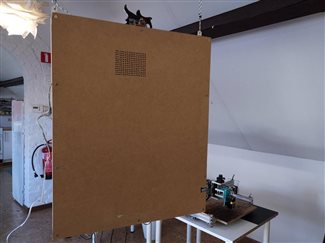

Finishing the Assembly
To close the back of the mirror frame I have 3D printed a series of spacers to fix the back leaving internal air circulation.
Then, after gluing ten spacers on the border of the frame I have closed the mirror with a sheet of MDF 3 mm thick
In the below images: the magic mirror installed and "visible" by SevenOfNine
