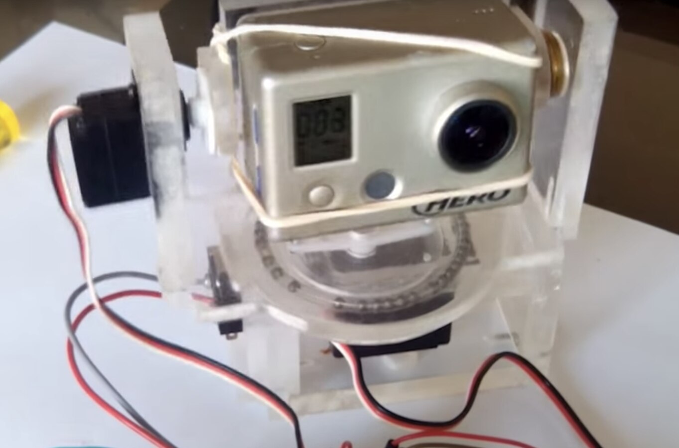

    Hello Dave (bis) I have reviewed again your idea. Take a look to the video below, I have already applied it in the past to make the camera pan prototype: www.youtube.com/watch I worked fine in this case…

    Investigated on a bit more and found this: Triangle Manufacturing - Lazy Susan Bearing Applications  So, what I am doing with the bearings (bought 1000 3.5 mm bearing balls) is a Lazy Susan mechanism? I used it in a lot of cases, loved it and never known its right name image image image image
    Well. Please, let me rewind a moment and see what can be right from both our ideas (including the non-viable suggestion of beacon_dave that opened the door to find alternatives).
    1. The large base support should be added as it is non-regular surface and I need the torso moves smoothly on the Lazy Susan (yeeee) bearing but also creates a base similar. Anyway it can be reduced and probably made more regular
    2. The use of gears should be excluded, not really for the design complexity but because the system is and should remain a bit fuzzy. Using gears for life-like movements generates sorts of Frankenstein effect or a lot of software to manage the right acceleration and deceleration curves is needed.

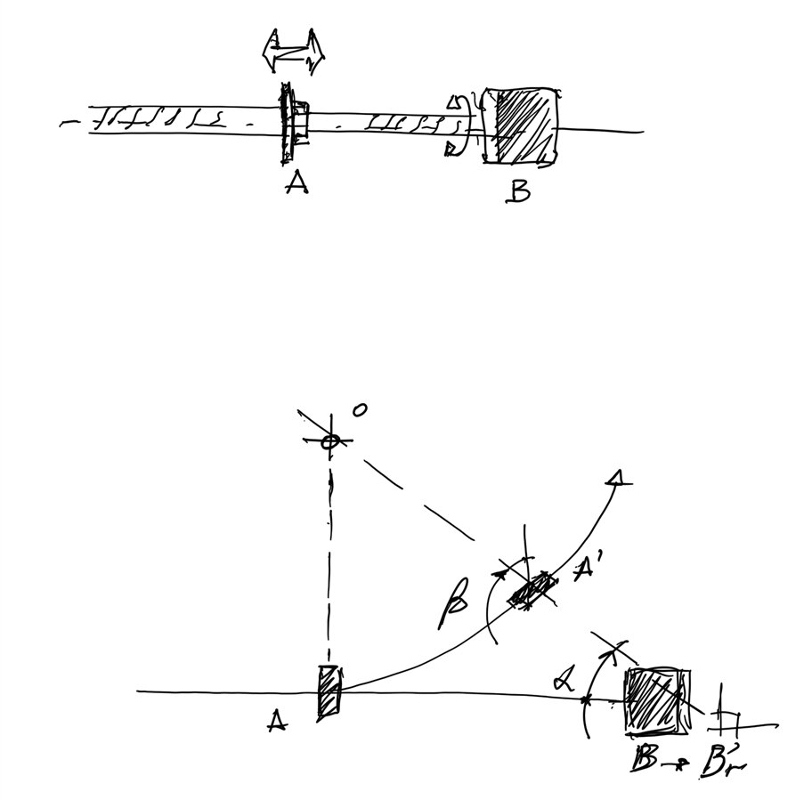

    3. The threaded bar solution can be excluded too as maybe easier than the gearing mechanism but implies two vertical rotating nodes, two bearings and the distance body-torso may increase too much. I have considered this kind of motion and two nodes are indispensable. Look at the sketch below.
    Assuming that A is in the midpoint of the threaded bar and B is the motor when moving the torso rotating around the center of rotation O (the already existing shaft) Moving the torso from point A to A' the node should rotate by the angle beta and the motor should rotate by the angle alpha. (If I am not wrong, alpha and beta are complementary?) This means that both the motor and the torso node should be mechanical complex, with bearing, rotation etc.
    Based on these considerations, I will redesign the rotation mechanism but using the motor connected to the Lazy Susan base with a fixed tooth belt. The large pulley should not be complete but only will support the small angles rotation in both directions. With the advantage that - ad Dave correctly suggested - the distance base-torso decrease as the motor can fit inside the already present hole of the top leg base.
    Please, let me know if this sounds reliable. Enrico
