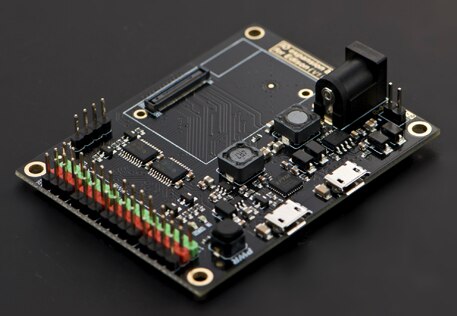

While I was watching one of the Intel Edison videos, they talked about suppliers.
When I first purchased my Intel Edison, they were so new that third party manufacturers hadn't geared up to support them.
Intel had produced a couple but IMO they were limited either by the size, or by a lack of onboard level conversion, hence it sat waiting.
Roll forward to 2017 and those third party maufacturers have come to the party.
More importantly the price supports makers that want/need to incorporate them.
DF ROBOT
DF Robot have produced a low cost Expansion that incorporates level conversion, external power and headers that suit brick style sensors.
https://www.dfrobot.com/product-1244.html
          Photo source www.DFRobot.com
The price is very reasonable at USD$13.90 and at 70 x 55 mm its larger but useful.

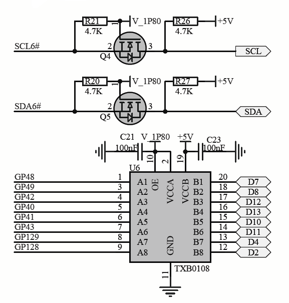

The folks at Df Robot have included a schematic and a good explanation of the pins in their wiki.
https://www.dfrobot.com/wiki/index.php/IO_expansion_board_for_Edison_SKU:DFR338
https://www.dfrobot.com/wiki/images/e/e8/DFR0338_pinout.png
    Image source www.DFRobot.com
The D0-D13 pins are 5v level, which gives a wide range of sensor compatibility and are fed via a TI TXB0108 ( TXB0108 8-Bit Bidirectional Voltage-Level Shifter with Auto Direction Sensing and +/-15-kV ESD Protect | TI.com  ) with 15KV ESD protection.
I was interested to see that the I2C are fed via discrete devices directly from the Edison, and have the 4k7 pullup already fitted.
So it looks like I have some playing to do this afternoon.

    So I dug out Edison_1 which had the original sketch, and my leads and proceeded to connect the LCD. First wee hiccup. The LCD is but the board is I'm not sure why they would have swapped not only the 5v…
    mcb1 over 9 years ago in reply to mcb1 +1
    So snag number 2 is there are no Analogue connections brought out. On the Arduino Breakout they multiplex them using a ADS 7951 chip. So this board is for the D0-D13 ONLY. Mark
    First wee hiccup.
    The LCD is
    but the board is
    I'm not sure why they would have swapped not only the 5v and Gnd, but also the SCL and SDA pins from most other devices.
    My Itead Studio, RoboRED and YourDuino Ardino boards use the same format as the I2C backplanes.
    So it always pays to check.
    mcb1 over 9 years ago in reply to Workshopshed
    The schematic uses MP2307 as the 12v to 5v converter.
    Adafruit datasheet suggests it's a 3A (4A peak) device.
    https://cdn-shop.adafruit.com/datasheets/MP2307_r1.9.pdf
    The ss34 diode in series with the 12v and the 5v output is a 3A device.
    The TXB0108 spec says it can handle 100mA through the VCCB or GND pins, and if I read the specs right it might be capable of 50mA per pin
    http://www.ti.com/lit/ds/symlink/txb0108.pdf
    mark
