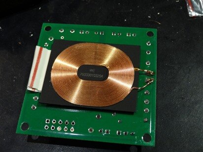

Receiver
For the wireless receiver, I added a small support board that holds the receiver PCB with the coil attached to it. I put the coil on the back side of the receiver PCB, and fixed it with two layers of Test Power Strips. That helped in leveling out the solder joints from the PCB:
I then mounted that PCB on an acrylic plate, and used standoffs and spacers to get it to the right height.

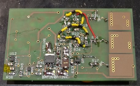

PCB reworks
Nearly all parts of my circuit needed some form of touching and reworks. What once was a nice board now looks quite patchy:
(Top side, with most of the reworks for the end-of-charge circuit)
(Backside, where the wires are for the differential amplifier)
On the right side on the back one can see the PCB areas designated as heat sinks for the balancer FETs.

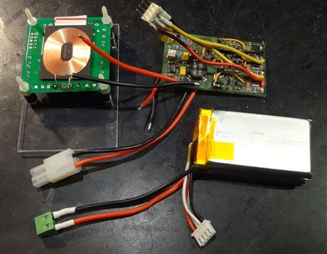

Connector puzzle
After finishing the PCB (and verifying that everything works as it should) I added connectors to put everything together:
Here the base plate is visible. It also holds the PCB, which gets half-hidden under the receiver board. To allow that, I removed the test points and the programming header from the receiver.
The battery is a 11.1V, 1300mAh race car battery (an extron X1), which comes with both a balancer connector (for charging) and power leads. I added a screw terminal to them, so I can remove it easily.

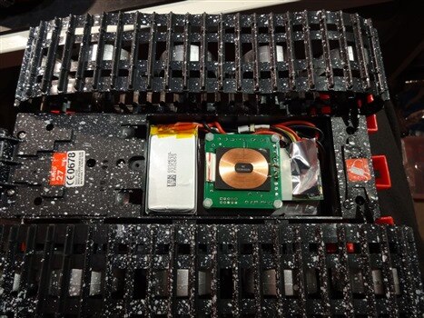

The final step
As final step I just needed to fit everything in the battery compartment of the snow groomer. Since I measured quite carefully, I knew how large all the stuff was allowed to be. So it was not a surprise that everything did fit in snugly:
The battery and the acrylic plate span together the whole length, to they hold quite tight. On the side there is enough room for the connectors. It was a welcome surprise, after all these set-backs in the last few days, that it did indeed work on the first try.

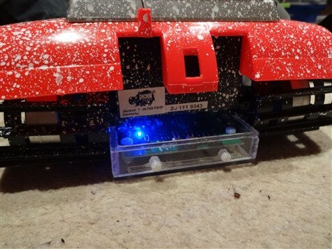

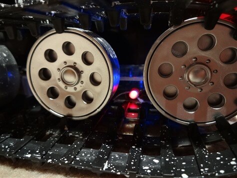

When putting it on the charger base station, I found out that it fit a little bit too tight - I should have save some millimeters there... But the charging notification on the transmitter turned on, and also my current sense notification. Even though its a little bit hidden:
I also should put the USB power cable entry not to the side, but to the front, since its now to close to the driving chain.
But the status LEDs from the transmitter a visible, so I consider this as OK.
