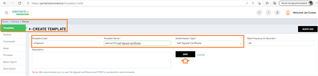

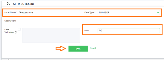

Create Template with Self Signed Certificate authentication
Save, Then add at least one attribute. I've been using Temperature in all the previous posts. I'll stick to it.
Save. You now have a minimal working template set up for self signed certificate authentication.

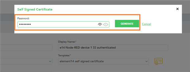

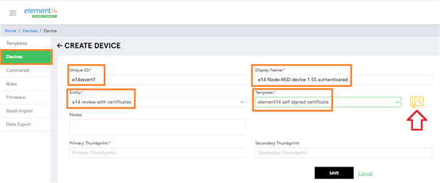

Create Device and Get the Certificates
You can now create a device, using that template.
Because the template is set up for self signed certificate authentication, the portal will create the certificates chain and keys now.
Don't forget to click on the certificate icon and get all the info. This is the only chance.

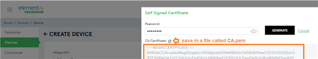

The system asks you to generate a password for the certificates.
Enter one, press Generate.

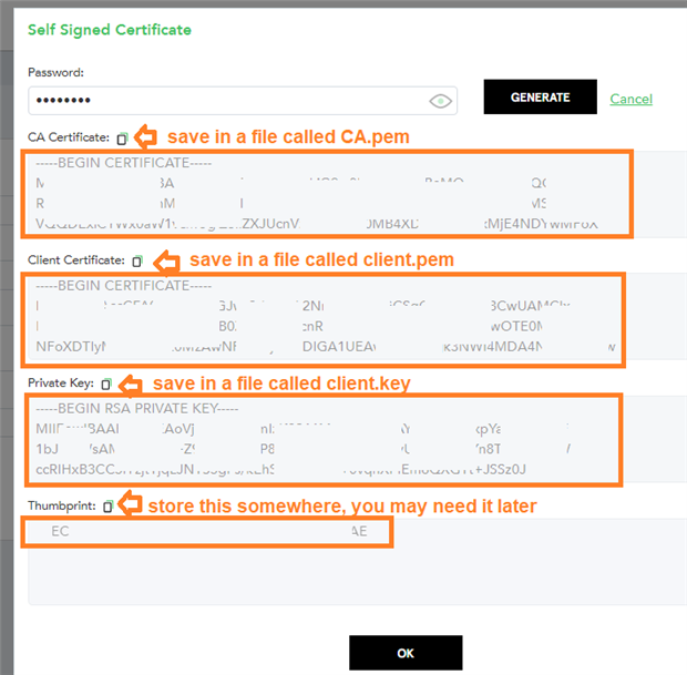

A pop-up shows with all the info needed to connect.
This is linked to your device on the cloud. You have to use this certificate collection to log on from Node-RED, or the connection will fail (and that is good).
You end up with 3 files:
  • client.key (key),
  • client.pem (cert),
  • CA.pem (root certificate)

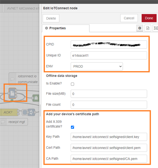

They have to be available to Node-RED.
I placed those on the client that's running Node-RED ('"the device", an AVNET Smartedge IIOTGateway):
/home/avnet/.iotconnect/.selfsigned/client.key
/home/avnet/.iotconnect/.selfsigned/client.pem
/home/avnet/.iotconnect/.selfsigned/CA.pem

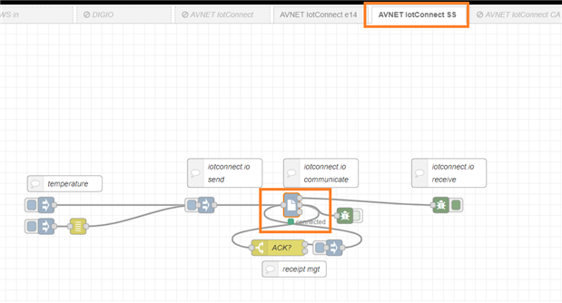

Then I copied my existing Node-RED flow from the previous posts, and replaced the Unique ID in the injection and IoTConnec nodes with the unique ID of our device here:
If you want to see the Thumbprint later and didn't store it: no worries. You can retrieve it from the certificate:
openssl x509 -fingerprint -in client.pem
Refer to this post for the correct ACK handling.
Deploy and enjoy.

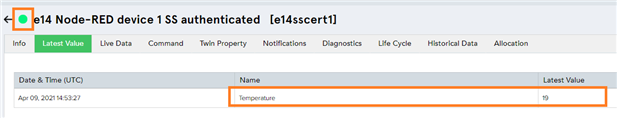

The connection is successful when the IotConnec node shows "connected" under its icon.
Here's the result of sending a temperature.
This is a good step from the previous authentication. More to follow.
