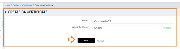

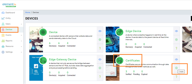

Load the CA root certificate to the IotConnect portal
The CA certificate will be used as a basis of trust by the IotConnect.io cloud services.
Any device that has a client certificate generated with this root certificate (and additionally is registered on IoTConnect and linked to this root certificate via its IotCOnnect Template) will be allowed to exchange data.

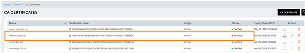

The certificate isn't trusted as a CA root when you upload it. It's merely stored.
More on the trust part later. Let's upload it first.

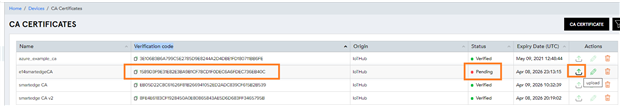

The not yet trusted certificate is on the server. I have to prove to the server that I have the password for this certificate (i.e.: it's mine).
You see that the status is "Pending":
Proof of Ownership
When I uploaded the CA root, the IoTConnect portal gave a challenge: a Verification code.
We need to show the service that we're able to generate a certificate from the CA root, where the certificate's common name (CN) is that verification code.
That's an exercise you can only complete if you have the CA root's password. I.e.: you own that certificate.

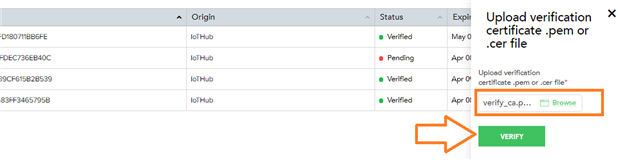

Once generated, use it to verify the CA root on the portal:
Click the upload button at the right side of the table, select the verification certificate, then press Verify.
This is a first milestone. You are now a trusted certification authority for your organisation in IoTConnect.io.
All certificates you'll generate from now on will be trusted. Until the CA root certificate expires image.

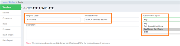

Create a Template for CA authorised Devices, and a Device
You define the behaviour of a set of devices on IotConnect with a template.
One of its attributes is the way of authorisation.
Template
Let's create one for CA authorised devices:

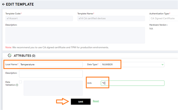

Save, then create at least one attribute.
I'm staying consistent with the blog series and create a Temperature.
I try to explain all steps in my posts. But this one we've seen several times now. Please read the previous posts if this attribute declaration is a mistery.
Save again.

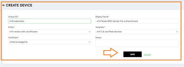

Device
Now register the Thing.
It uses the template that's just created. That means it will authenticate via certificate I'll generate, and can exchange Temperature.

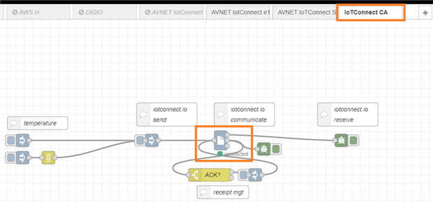

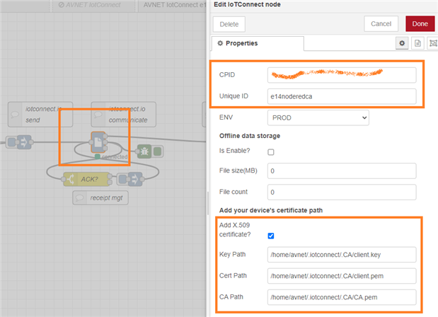

You can use a copy of the Node-RED Self-Service flow from the previous post to perform the test.
Just replace the UniqueID references in the Injection and IotConnect nodes with the one of the device you just created.
Point the x.509 attributes to the 3 files you copied over to the device:
Refer to this post for the correct ACK handling.
Deploy.
The IotConnect node should show a green flag.

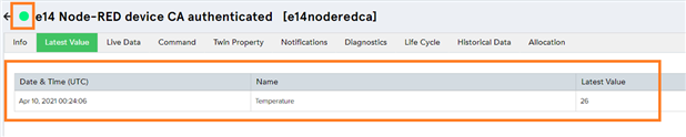

Inject a payload, then go look at the IotConnect.io portal:
It works.
