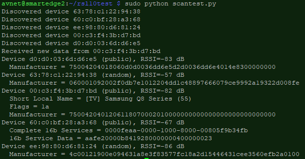

Scan for devices and get info:
scanner = Scanner().withDelegate(ScanDelegate())
devices = scanner.scan(10.0)
for dev in devices:
    print "Device %s (%s), RSSI=%d dB" % (dev.addr, dev.addrType, dev.rssi)
    for (adtype, desc, value) in dev.getScanData():
        print "  %s = %s" % (desc, value)
output (the RSL10 is 60:c0:bf:28:a3:68)
By default, the RSL10 firmware sends Eddystone TLM data, when in Environment Only mode.
            elif("aafe" in value and adtype == 22 and 'mybeacaddress' in globals()):             # Eddystone TLM packet (Service Data - 16-bit UUID)
                if (mybeacaddress == dev.addr):
                    print("Eddystone Battery")

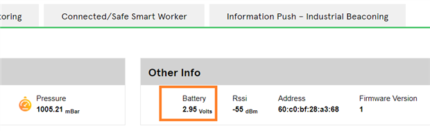

You can see the info in the log:

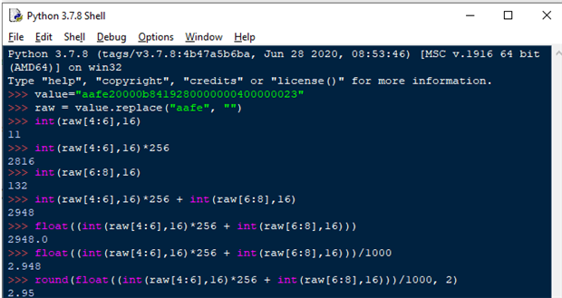

This is parsed by the sample project:
                    # Filter out the RSL10 beacon from other beacons
                    raw = value.replace("aafe", "")
                    battery = round(float((int(raw[4:6],16)*256 + int(raw[6:8],16)))/1000, 2)       # unit Volts
                    os.system('touch /home/avnet/ok')
                    batteryValue = battery
Let's review the battery:
2.95 Volt.

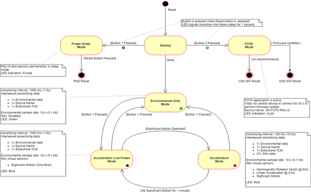

When you put the RSL10 in Acceleration mode (with the custom firmware that it is running, this is done by pushing user button 1 then shaking the device), it sends more info, 128 bytes:
The example code also looks for that signature, and performs different logic:
            elif("203606dce9dcb3b7745559262ee12305" in value and adtype == 33):             # ON Semi Advertisement packet (Service Data - 128-bit UUID) - MOTION DATA (Red LED state)

Custom Firmware on RSL10
The firmware loaded on the RSL10 is custom for this evaluation. It is comparable to the out-of-box, but has support for Over The Air firmware upgrade:
The output captures I've posted in the first paragraph are the Environmental Only Mode (default when starting up, green led) and Acceleration Mode (red led) BLE captures.
